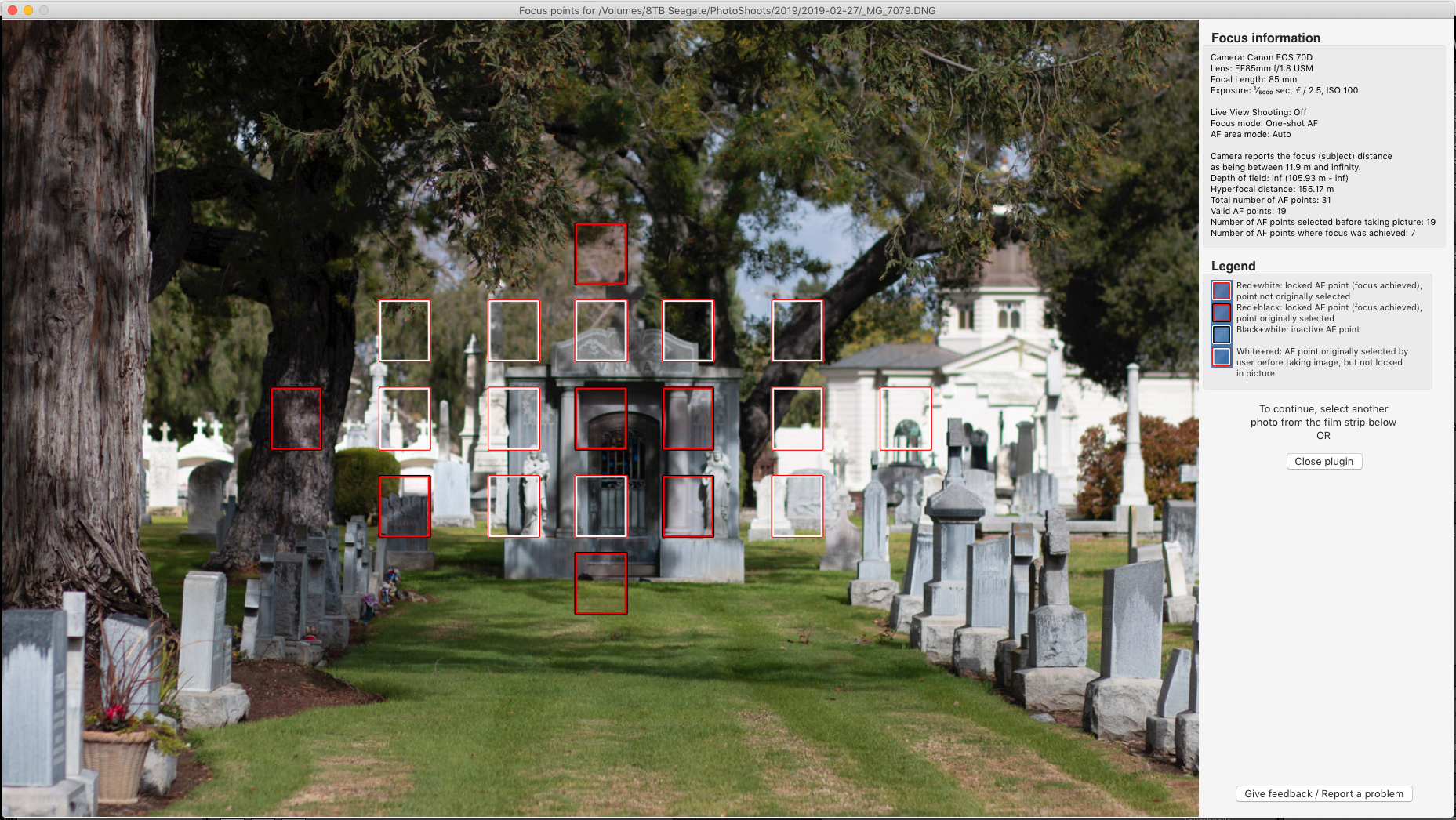

davetong
Canon D70, 85mm lens, 1/200 at f2.8
It's not sharp, even though the autofocus claims to have a good lock on.
Judging by the tiles on the floor it's focused a good 1m too short.
Does the camera need servicing?
Also, what's with "the camera reports the distance as being between 2.88m and 11.9m" - that's a massive range given the 0.78m depth of field
Original image at https://www.dropbox.com/s/agk1qtakqh9j4iz/_MG_6750.DNG?dl=0

Here's a better example:
https://www.dropbox.com/s/ius8xoh48ntrzv0/_MG_7079.DNG?dl=0
This was taken in Manual mode, using One-Shot focus. Same body and lens.
The leaves and the tree in the upper left and the gravestones on the right are sharp,
but the focus locks are supposed to be on the crypt in the distance.
I'm going to try cleaning the AF sensors

Here is the full, uncropped screenshot. And as I said before, the full, raw image is on Dropbox:
I recently purchased this 85mm f1.8 lens as a portrait lens. Unfortunately I don't currently have the budget
for the high-end lenses, and the kit 18-50 and 55-250 lenses don't seem to show the problem, probably because they are so slow.
I have had similar issues with the 50mm f1.8 lens.
The frustrating thing is that while it's not consistent I do find that several of the photos in a particular set will show the problem.

I think you gear is working properly. I don't think you understand how it works, though. The camera will always try to put the closest thing in critical focus. The rest may exceed your DOF. If I read your EXIF correctly you shot at f2.5 using an 85mil..  Pretty small DOF at that aperture.  Do this for me, turn off all the focus points except the center one. Use only the center point.  Use One-shot. Put the camera in P mode. Take the very same photo if you can and focus precisely on what you want on sharp focus.  I bet it will be fine.

Well the entire point of the test was to shoot at a wide apeture for narrow DOF, with a fast shutter to rule out camera shake, and to exercise the 19 point AF. It seems odd that the camera would focus on objects outside the range of the autofocus points and still report that those points were in focus, so clearly my understanding of how autofocus is supposed to work is different from Canon's.
From what you guys are saying the only autofocus mode that actually works reliably is one shot with the centre AF point, so I'll stick to that for now.

Your LR plug-in cannot determine which AF point was used to lock focus at the moment the shutter was fired.  It is only able to display which AF points were capable of locking focus.  Also, AF points are little larger than the squares you see in the viewfinder or the LR plug-in display, not a whole LOT bigger, but they do fill in the empty space between squares.
Sorry, but your understanding of DSLR AF systems is a little flawed.  It is not a question of how you feel it should work.  It is a matter of how it actually works.  When you have all AF points active, what critieria should the AF system use to select an AF point for focusing?  Many more times than not, the user is trying to focus on the nearest object to the camera.
At this point we cannot conclude that the camera focused on a tree at the left edge of the frame.  THIS is why you are being asked to use only one AF point, so that a determination can be made which AF point locked focus.  This is why you were asked to use the Canon DPP software to read the AF points.
A determination needs to be made as to whether or not your camera is focusing accurately.  It could be experiencing what is known as “back focusing” or “front focusing”.  We would like to help you and guide you in making this determination.
Additionally, you should only be using the viewfinder for focusing and composing your shots for these tests.  Do not use the Live View method, which uses the rear LCD screen as a viewfinder.  The LCD uses a separate focusing system, which is not as accurate as the AF system employed when you use the viewfinder.

All the above info is nice to have but all you really need to know is, for the shot you displayed you used the wrong focusing pattern, too wide of aperture and unnecessarily fast SS. The camera will try to grab the closest object. When you have may points for it to select from this is what you get. In certain circumstances it is beneficial to use this. A bird in flight for instance. For a landscape type shot it isn't so great. Close the aperture down to f11 or f16 and select a SS around 1/100. Try again.
With the aperture around f11 or f16 the multi-AF point may work, OK, too. Remember the DOF from an 85mm lens at a wide aperture is narrow.
