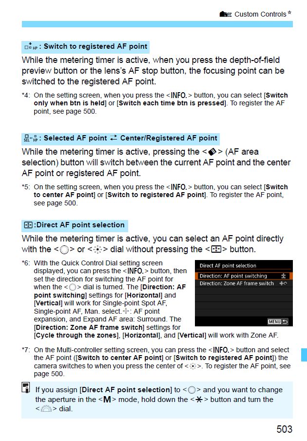

The default behavior of the joystick needs to be changed in the Custom Control menus.

I think a better idea would be to review my initial post.  Pay close attention to the lower part of the page.
That page is from the Custom Controls setup menu.  The default behavior of the joystick is [DISABLED] until you press another button to, THEN the button comes to life.

OK, I finally see what Waddizzle is referring to: the "Custom Controls" menu in the next-to-last (orange) menu group. If you set the Multi-Controller button to "Direct AF point selection", you can use it to select the AF point. You still have to push the "AF on" button first (or the shutter button halfway), but it may give you what you're looking for.
EDIT:  And I've now verified that the same setting enables the same behavior on the 5D3 as on the 5D4. So your 5D3 must have been set that way, even though it isn't the default.

By pressing the [SHUTTER] or [AF-ON] you are activating the metering timer.  When this happens, the joystick is normally disabled, by default.  You can reprogram the button so that when the metering is active, which is also when you can view your active AF point dynamically, you can now use the joystick to select an AF point.
Why is [DISABLED] the default behavior?  That's good question.
