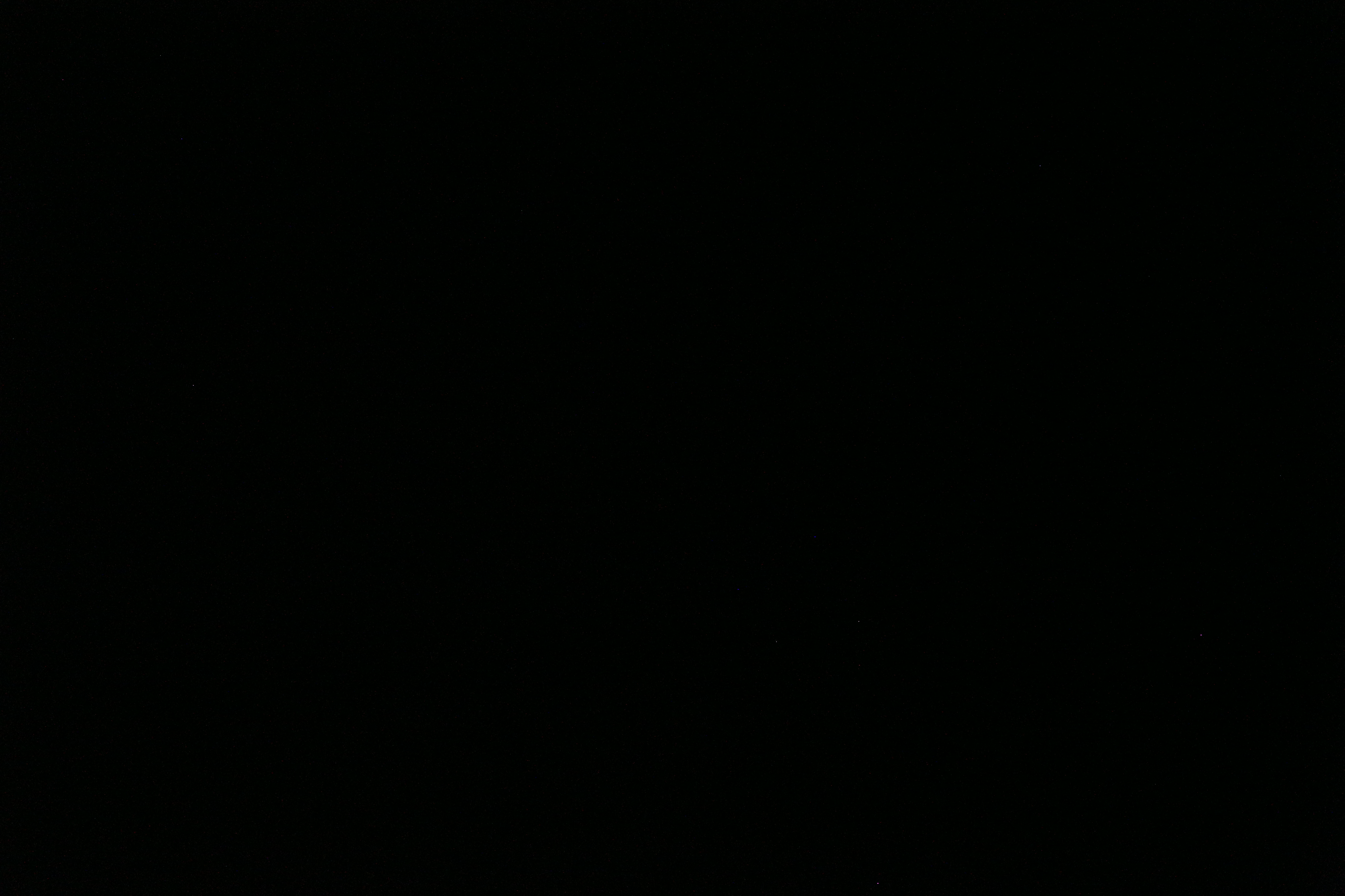

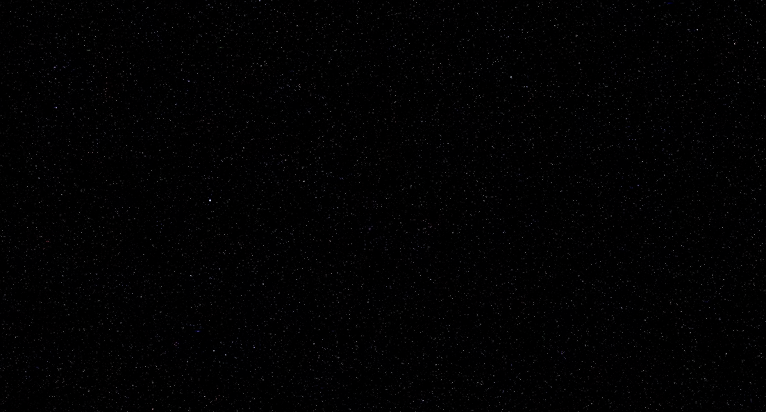

So I bought a 90D a few weeks ago to replace my aging T4i for some astrophotography. The first couple nights out I was having a few issues I'm still working out, but one of the big issues was the impressive amount of what appear to be bad/hot pixels in my images. When I say impressive, I mean impressive, its like I created my own artificial star field impressive.
I was using 5 minute subs (individual photos) and ISO 1600 (though on my previous ISO 800 shots they were still just as bad), and the level of bad/pixels was concerning. You can tell that they are bad/stuck pixels because as the intended star field shifts between the photos, these pixels remain in place.
This is one of my dark frames, aka an image taken at roughly the same temps and ISO as the "light" frames, but with the lens caps on and no external light reaching the sensor. This is a small patch at 100% pixel for pixel (this is NOT the whole frame, but a small 1000x600 100% zoomed in cropped patch), and it is like this across the whole frame, on every image. Is this high of a saturation of bad/hot pixels on a brand new camera normal?
I know my T4i was nowhere near a fraction of this, which is why I was so suprised by it. Though my 6D2 does have a fair amount of bad/hot pixels I have to contend with even with 30 second Milky Way images, but again, nothing on this scale/level.

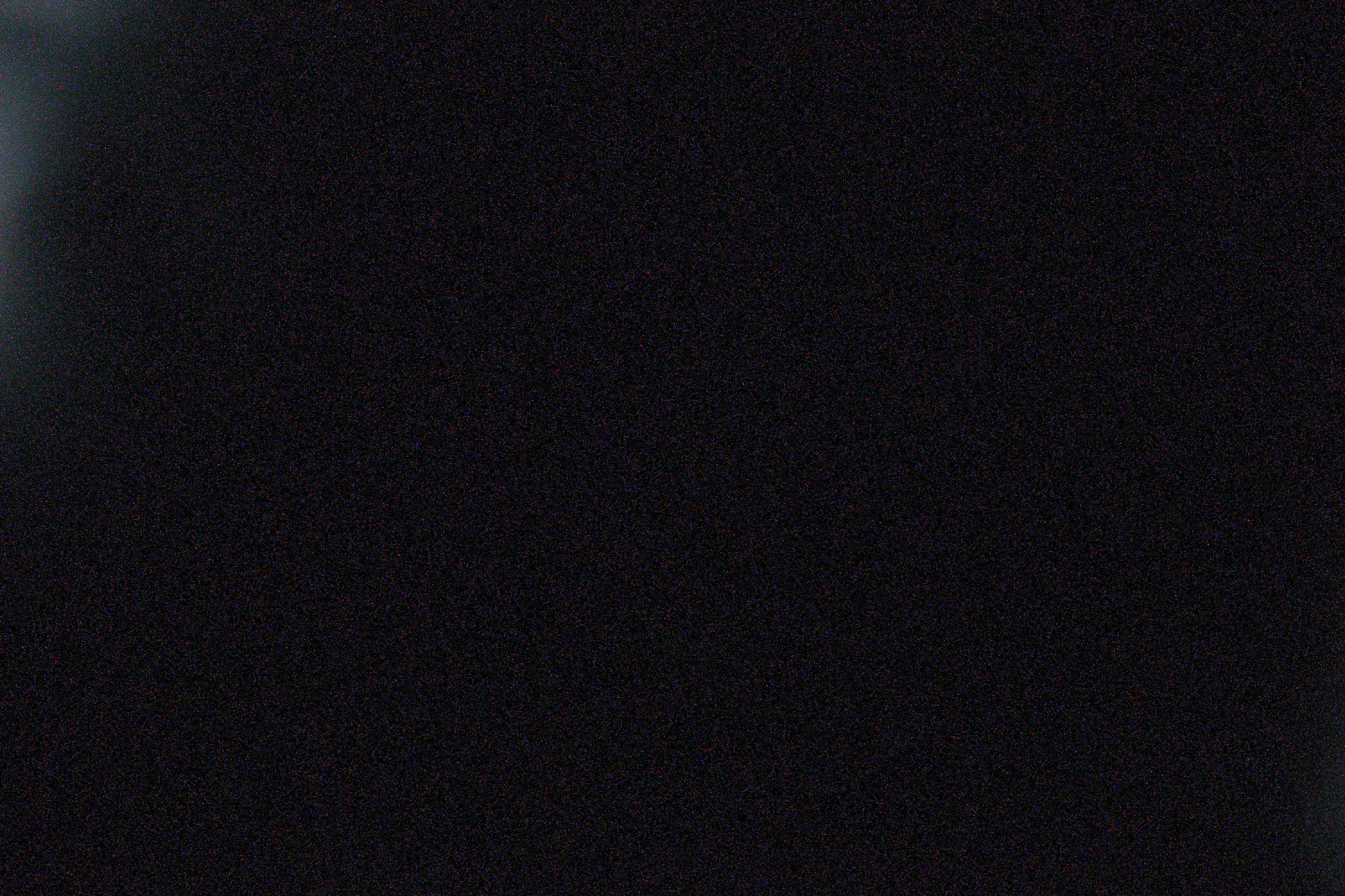

Seems normal for 5 minutes (but I think you should have more coloured pixels and darker frame). Why not shoot ISO 6400 to be able to decrease the time and the heat?
Here is from my 6D at 5 minutes and ISO 1600 and 1:15 and ISO 6400. Exif reports 21 and 23 degrees Celsius.

So your 6D at 5 minutes, ISO 1600 still has probably thousands of times less bad/hot pixels than my 90D, 5 min, 1600 does... not a helpful comparison to say that it is normal and expected. I can zoom in to 100% on your 6D image and I can actually count the number of bad spots... but the question is, can you zoom in to 100% on my 90D image and count the number of bad spots? My image I posed wasn't the full frame, it was a 100% zoomed in crop of part of the image.
So you are saying since you don't have a 90D that it is normal for me to have thousands of times more bad/hot pixels than you have on your 6D? I'm also curious to know how you are able to find the sensor temp value, as that would be extremely handy to have for building a dark library and correctly matching temps between lights and darks.
And I am extremely hesitant to attempt astrophotography at ISO 6400 because of the severe hit to dynamic range. In astrophotography, you primarily adjust the amount of light the camera collects by using the lowest ISO you can with as long of an exposure as you can get, due to the significant reduction in dynamic range as the ISO increases. Which is why I specifically mentioned this was for astrophotography.

What more have been done to your image? Almost no hot pixels with colours and no Exif. A raw sample would be better.
Have you tried higher ISO and to stack more pictures? ISO 6400 and 18000 pictures pixls-discuss.s3.dualstack.us-east-1.amazonaws.com/original/3X/f/4/f4bba7b9b82eb48e51c8741706eaf08469beaa2c.png
Below the fourth 5 minutes dark frame from my M5 at ISO 1600.
