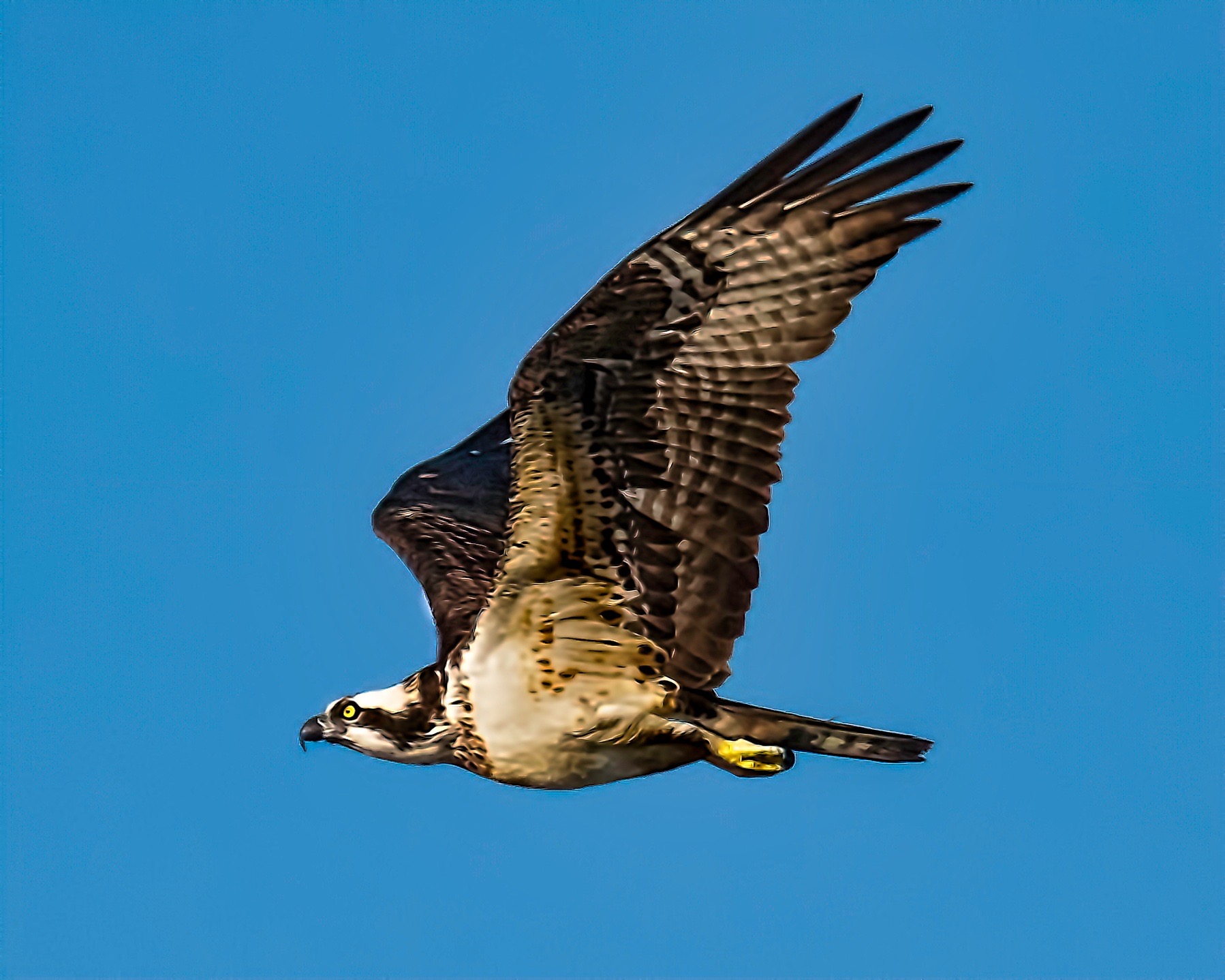

thanks for suggestions I am using a tripod and same thing happens using the 15 points, which is what I use most of the time and I do have focus priority on both 1st and 2nd, this does not happen all the time but it is frustrating when you see focus lock on the bird and yet not in focus or not focus lock but bird in focus, just kinda weird. I have a keeper rate of around 35-40%, which I am ok with. but just can not figure out why some work. Here is one with nine point zone, one point locked and some editing.IMG_8229toplum.jpg
"...one point locked and some editing."
Some editing?  Go easy on the sliders, less is often more in photography.
EB
EOS 1DX and many lenses.
"thanks for suggestions I am using a tripod and same thing happens using the 15 points, which is what I use most of the time and I do have focus priority on both 1st and 2nd, this does not happen all the time...
.... but it is frustrating when you see focus lock on the bird and yet not in focus or not focus lock but bird in focus, just kinda weird.
I have a keeper rate of around 35-40%, which I am ok with. but just can not figure out why some work. Here is one with nine point zone, one point locked and some editing."
Yeah, a little too much editing on that image.  It almost looks like a complete background swap, too.
When you use multiple AF points, do you see the AF points blinking on and off [they will be grey, not red] as they track a subject?  The display can show you where it can lock focus, as it displays multiple AF points.  In AI Servo mode, it does not show you where it has locked focus, just which AF points have the potential to lock focus from one moment to the next.
If you miss your target, then it stops tracking your subject, but the AF system will keep hunting.  You can pause the AF, and re-acquire the subject.  This behavior is also programmable.  You can set how fast it switches from one AF point to the next when it is tracking.  You can set how fast it switches from one AF point to another when you lose tracking on a subject.
Also, make sure that you are NOT using Spot Focus when using just a single AF point for shots like your sample.
You are kind of far away.  Only one AF point can cover your  subject.  Being closer would also help improve your keeper rate, because more AF points will be feeding data to the AI Servo focus tracking system.  Although 35-40% is really not all that bad for action shots of BIF.
