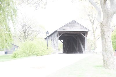

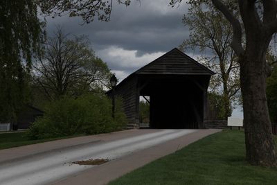

Here's an image several stops under-exposed...
For the above image, we really only care about the brightest bits.... we want details from the sky.

And here is an image several stops over-exposed...
For this image, the computer is only interested in the darkest bits... in this case it will use the data from the interior of the bridge where you see the wood beams.

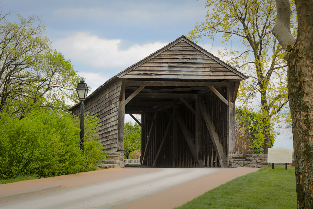

I combine these using HDR software (Lightroom, Photoshop, and many many programs have a feature built in to do this.  But the popular commercial product that specialized ... software designed *just* for the purpose of doing HDR ... is a program called "Photomatix Pro" by HDRsoft.
Here's a merged result:
Sure I've cropped, boosted color, and messed with lots of stuff... but the point is I've "compressed" the tonal range so that nothing is extremely dark (so dark the eye thinks it is black even when it isn't really black) and done the same for the lights.
You have LOTS of tone-mapping choices when creating HDR images and many do not look realistic.  I've tried to make this one a little more realistic.  I want the interior "dark" (because it should look dark even though you clearly saw we have the data to brighten that up quite a lot if we want) ... I'm just trying to get some detail on the wood beam construction inside the bridge.
I could have done this using just one image... but I did it both ways to show you.
