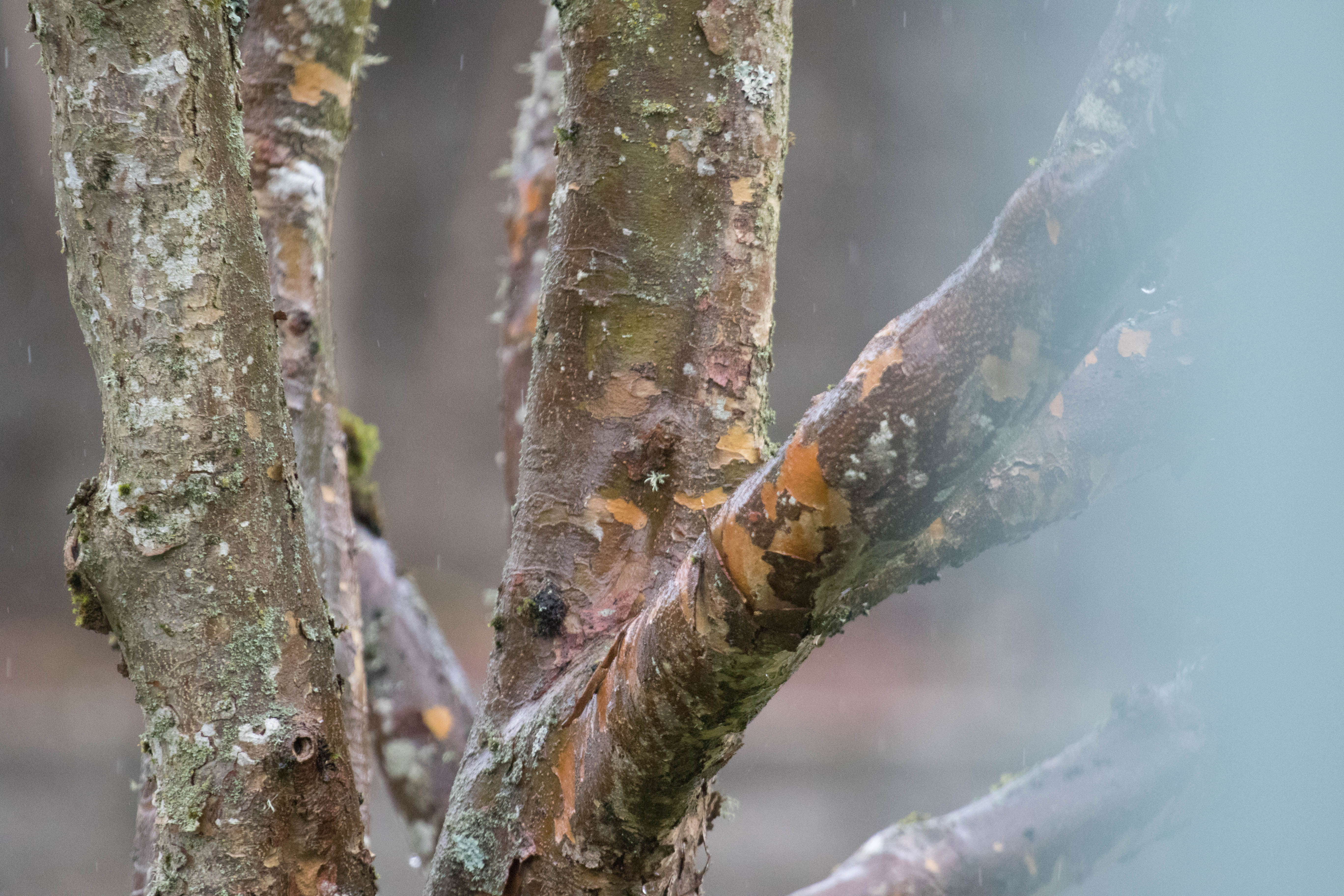

Recently purchased a new &d MKii. (yesterday) Using a Conon 100-400 lens and taking pictures high speed and continuous with the shutter release button and then looking at the in Lightroom all the pictures "grayed out" about 30% on the right side of the photo. How can this be. This is the 8th canon camera that I have owned and used. I have never seen this before.

Well that's pretty weird...
It doesn't look like a failing shutter, and it's obviously outside, so not a flicker problem (not that the original description sounded like that anyway).
It actually looks like something physically between lens and subject, but I guess we can rule that out.
Is it happening all the time? What about other lenses?

The camera is a new out of box 7D MK II. (one day) This is a software issue at higher ISO 5000 and faster but not on continues mode. There are over a dozen picture's that look like this. But the gray-out fades in and out depending on continuous shutter actions.

Is it only in Lightroom? What if you look at the image on the camera screen?

The pictures are the same on the camera screen.
