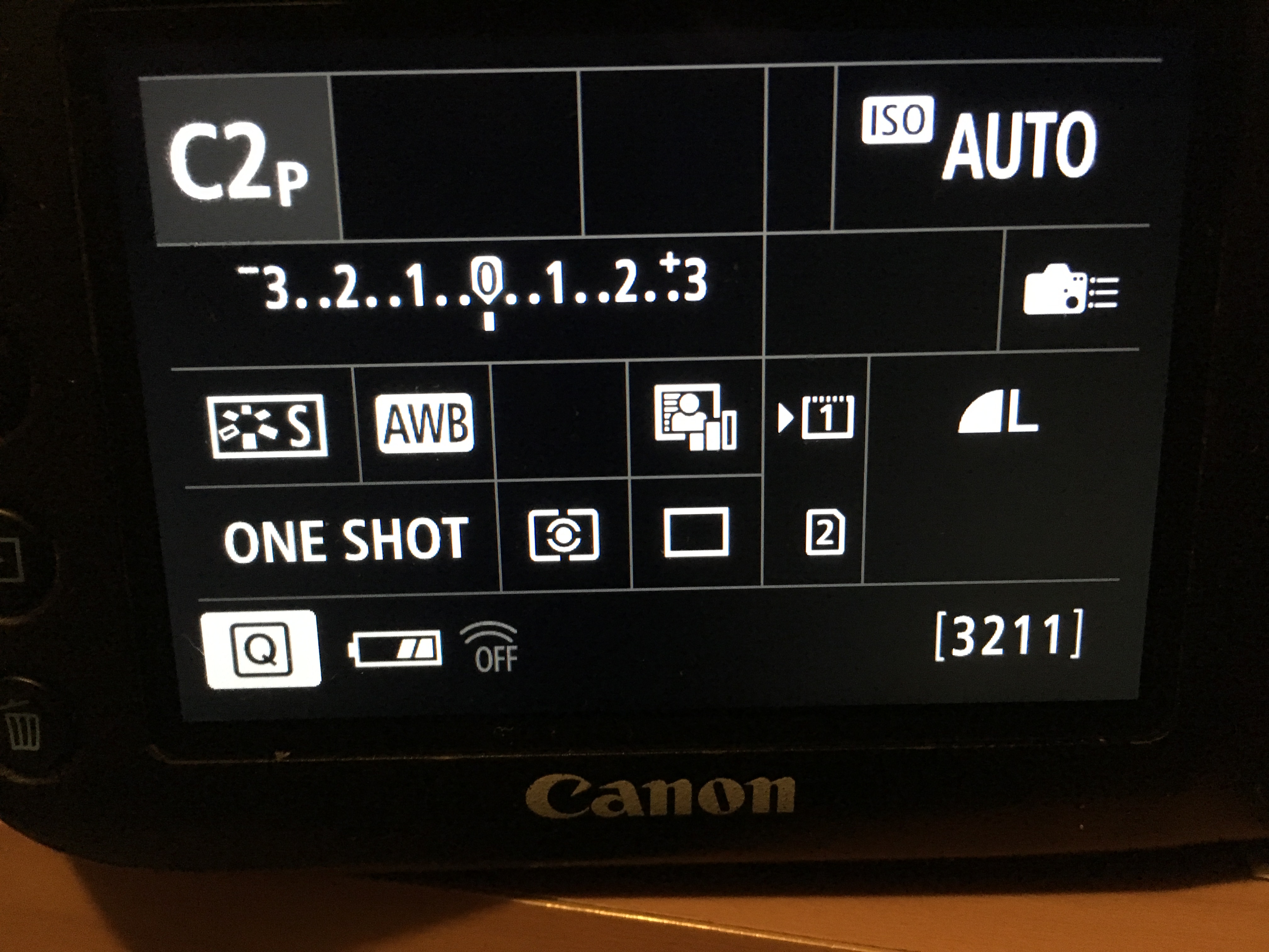

I can’t seem to store any custom shooting modes on the dial C1, C2 and C3. When I set the dial to these and check the details with the Q view, on the left top square it says C1p, C2p and C2p (that’s right C2 and C3 show the same). I have tried clearing the wrong settings shown in the Menu without effect - the details remain unchanged.
Would appreciate your advice on how to fix this problem.
Regards
John
If resetting the camera, as shown above does not help, then you need to call Canon. It might actually be a dial malfunction if it can't tell the difference between C2 and C3.
You did program them, right?
Thank you for your response.
To program the custom shooting modes, I set the dial on M and enter the settings I require. I then go to the menu and clear say, C3, and then press "Register". I have also tried not clearing the register before registering the new setting - hasn't worked either.
I have no problems with the settings I set for AV, TV and M. Only problem I see is when I try to register any settings on C1, C2 and C3.
I have the latest firmware, but this problem started before I even updated the firmware. The camera used to work fine until I think I may have accidentally pressed some buttons on the camera.
This is what's shown on C3. C2 is the same. C1 is the same except for "C1p" being indicated on the top left corner.
I am going to guess that the "P" means that it has not been programmed. Did you follow this procedure:
https://support-my.canon-asia.com/contents/MY/EN/8202216800.html
