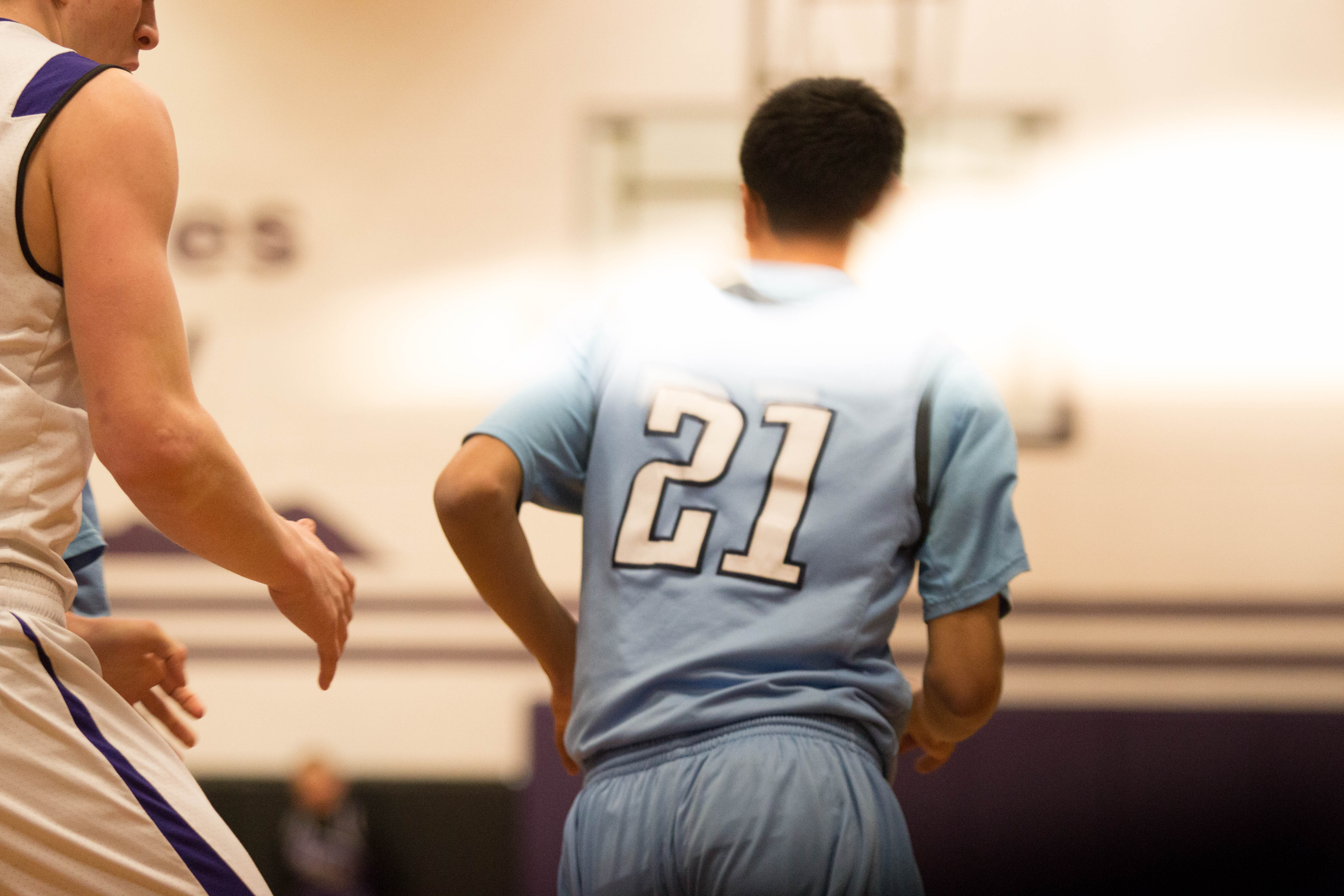

Hi- I have a 70D and was out shooting a basketball game, when out of nowhere a big streak of light started showing up in every frame. I was wondering if anyone had a similiar situation and knows a solution?
Thanks

02-21-2015 12:33 PM
Yeah, it cost about $225 to repair.
02-21-2015 02:00 PM
I figured it would be about that much. I'm still waiting for a quote. Missing my camera.

I also have the 70D and have seen several threads like this in the last couple of days. How old is your camera?
03-19-2015 12:24 AM
Did you send it to Canon Professional Services, or did you have it repaired at a local shop? My 70d is 16 months old, and it just cropped up on my camera. I am investigating whether I should sign up for CPS.
It seems that there are quite a few of these that are cropping up at the same time.
I'm just curious, but how old are the camera's that are experiencing this issue?
03-19-2015 12:43 AM
I sent it to canon, my camera was about 13 months old when i sent it out, and only had about 65,000 frames on the shutter.
03-19-2015 12:56 AM
It's been fixed. Replaced shutter. Little over $300 for fix and clean. Back in business again.

My camera just came up with the same issue yesterday morning. I was shooting fireworks with it on the night of the 3rd and yesterday morning I went to shoot wilflowers and had this alien light in every photo. I've had my camera for about 18 months and shoot it every single day. Definitely seems like a 70D Canon flaw. I have a t1i that I shot as much and never had an issue with it.
07-05-2015 10:55 AM
07-05-2015 05:43 PM
I was fortunate enough to have enough equipment to be able to enroll in Canon Professional Services and they were kind enought to repair my 70d without argument or question. If you are unable to enroll, I would suggest that you call Canon directly to see if they will repair it without charge since this seems to be such a prevalent issue.
07-05-2015 08:18 PM
Thank you for that. I will call them tomorrow 🙂
