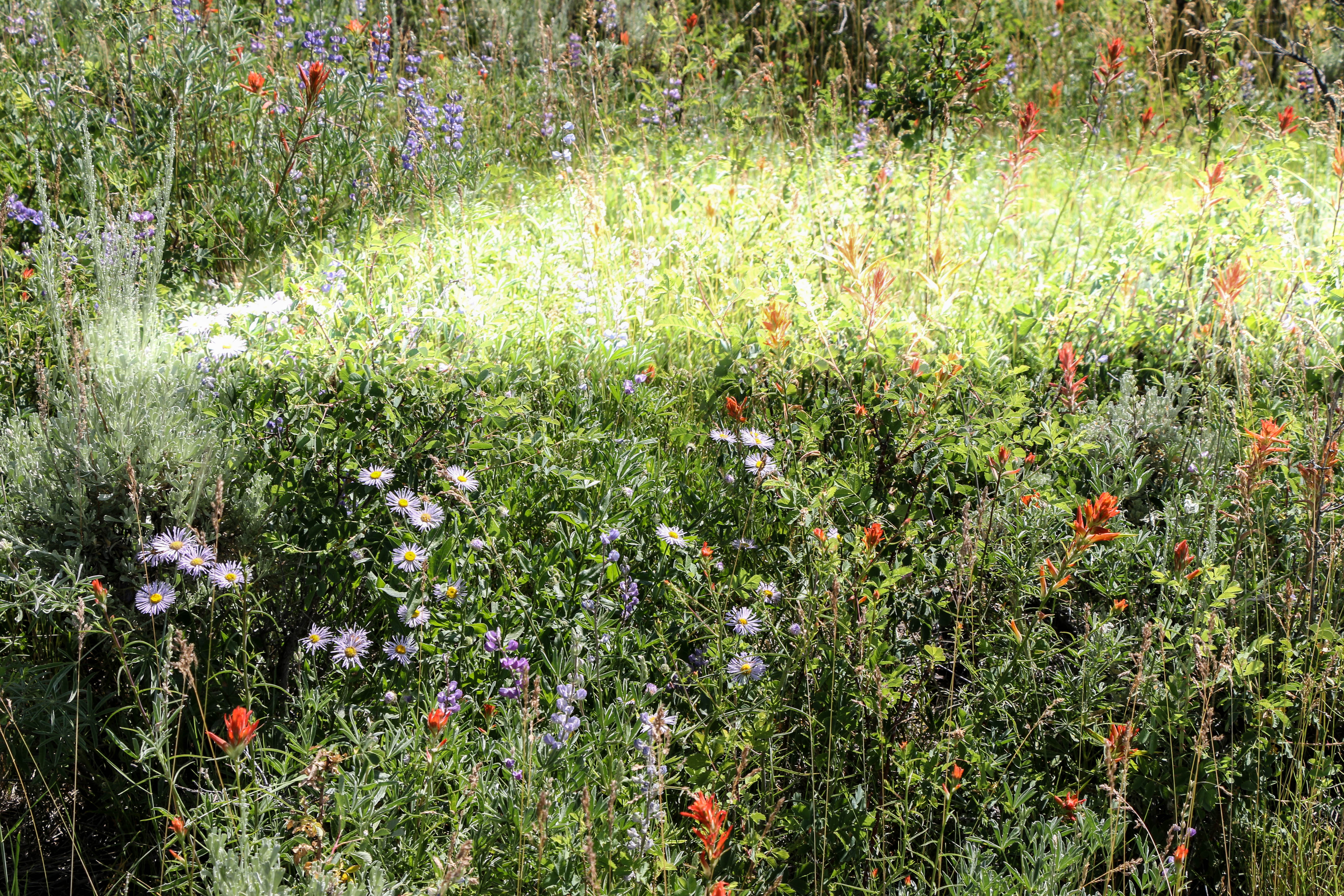

My camera just came up with the same issue yesterday morning.  I was shooting fireworks with it on the night of the 3rd and yesterday morning I went to shoot wilflowers and had this alien light in every photo.  I've had my camera for about 18 months and shoot it every single day.  Definitely seems like a 70D Canon flaw.  I have a t1i that I shot as much and never had an issue with it.20150704-IMG_6940.jpg

I was fortunate enough to have enough equipment to be able to enroll in Canon Professional Services and they were kind enought to repair my 70d without argument or question.  If you are unable to enroll, I would suggest that you call Canon directly to see if they will repair it without charge since this seems to be such a prevalent issue.
