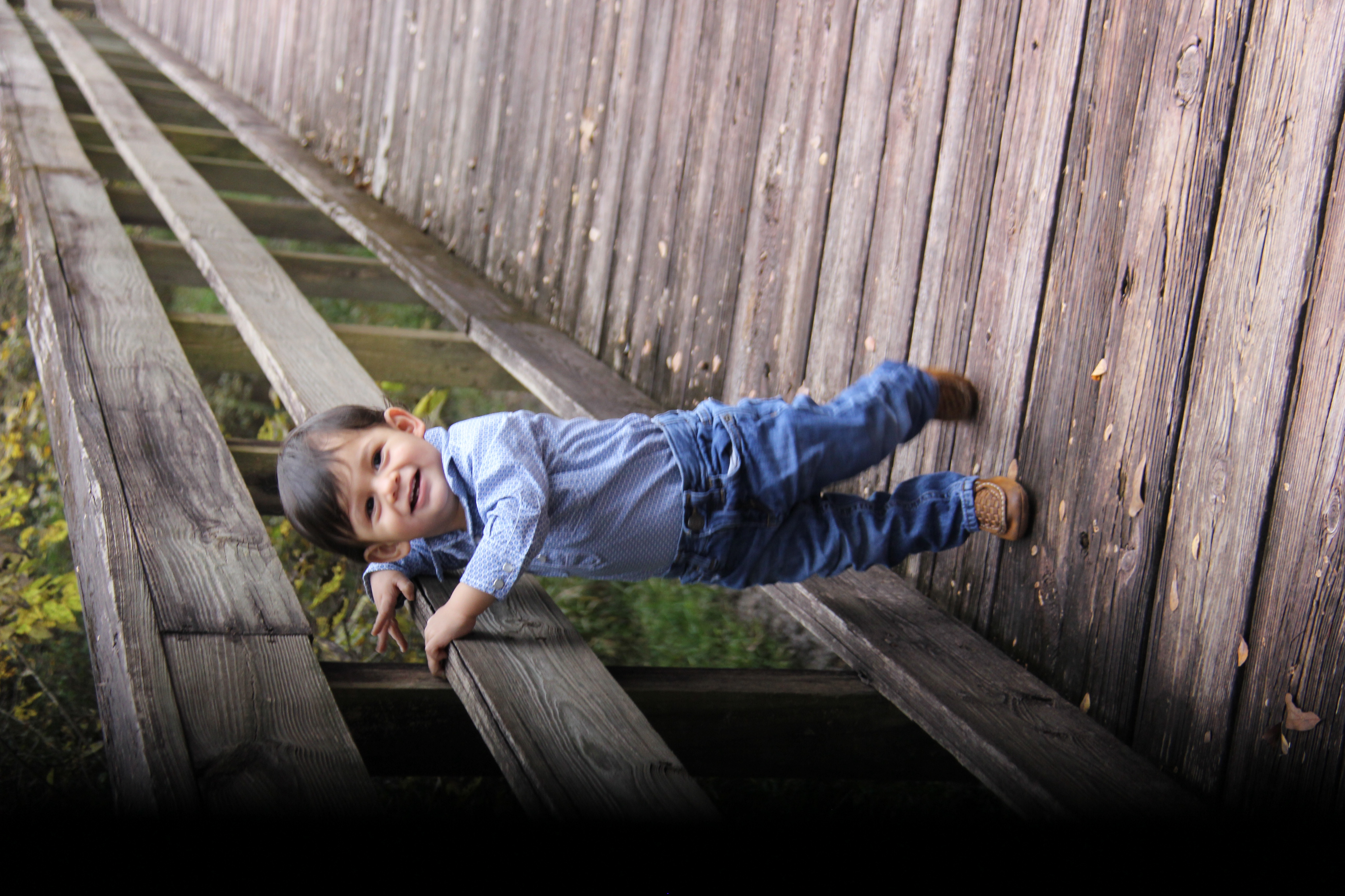

belen.jpgThis is the other image , the black shadows are to the left
The "shadow" Is underexposure caused by a shutter blade being slow to get out of the way. That it's related to the fact that the camera got rained on is unproven, but it's a reasonable guess.
And it's on the same side of the frame in all of the examples you showed. That it's to the left of the subject in this one is a consequence of the orientation in which you held the camera.

Show these samples to your local camera shop.  They should also tell you that your shutter is failing.  As noted, the dark spot on the left is a result of how the camera was oriented when you took the shot.  They should tell you that, too.
