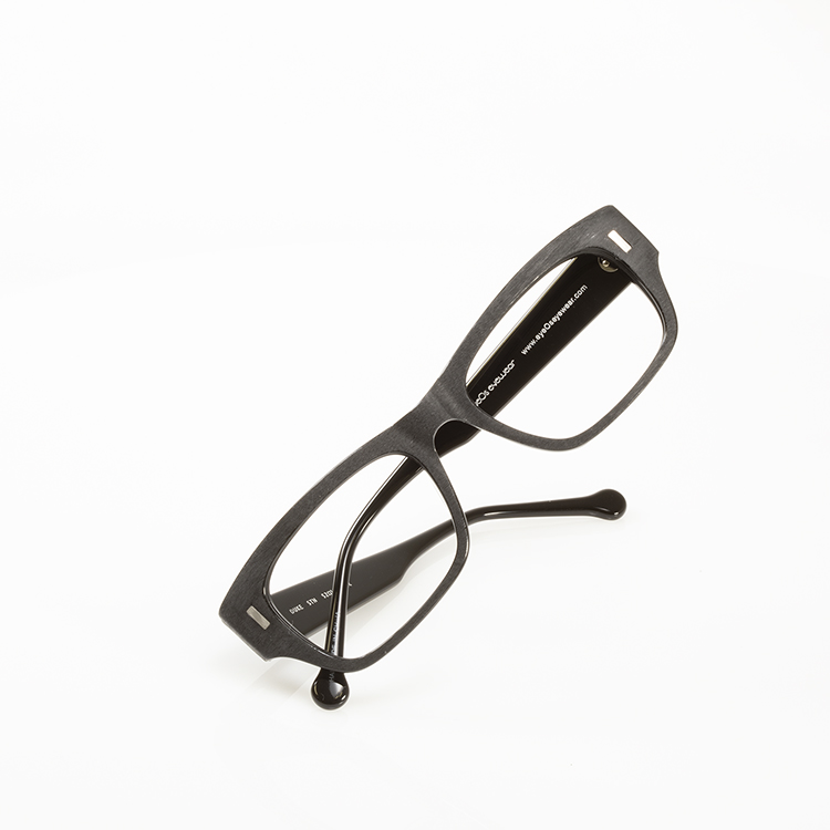

I'm shooting product and taking several shots with same settings with the following: Canon EOS 5D Mark IV Lens EF100mm f/2.8 Macro USM Setting f32 / 1.6 ISO 100 without making any changes or any adjustments to lighting or settings, every 3rd or 4th shot i get an overexposed image. below is 2 examples that i just shot for this post

You can try that but it will not help. Your problem is not light flicker. You have a correct exposure and then you have an over exposure, by several stops. If light flicker is happening the light flickers off, not brighter. Which is what you would need to get an over exposure. A two second SS will see the same amount of flickers anyway!
Since you are shooting at f32, I will bet the lens is not closing all the way down to f32 on the over exposure. This could be due to a faulty lens and is almost the only way your problem can happen.

Since these aren't individual images with EXIF data, I can't inspect camera settings or what the camera did.
Tell me more about mode & settings used.
(I have no issues with my 5D IV)
Were you using flash and if so, can you share details on that equipment and settings as well?

i wasn't using a flash. Here's a list of the equipment and settings:
Lighting setting exact for
GVM Dimmable Bi-color LED Video Panel Light set at 6000
These photos have all the properties

Many types of lighting (including LED lighting) pump out just one true luminosity ... but they do blink (flirker) rapidly. This includes florescent lights, LED lights, and many others. This is usually not noticeable to people ... but the metering system can detect it.
AC power cycles 60 times per second. So it's possible with a fast-ish exposure to have the camera take the shot at dim point that the eye doesn't notice. If you burst several frames in a row, you get some bright, some dim, many people think the camera is broken ... but it really did capture what was happen at that moment (nothing wrong with camera).
"Flicker Compensation" is meant to detect the cycle rhythm and have the camera take the shot at the moment the lights are bright so that you don't get under-exposed frames.
LED lights also flicker ... most diodes only put out one true brightness and the perception of dimming an LED comes from changing the frequency of how fast it blinks ... the light "seems" dimmer to us.
Dimmable LEDs are generally blinking fairly fast ... and according to the EXIF data, these are both 2 second exposures.
On the other hand... It shows you used "Manual" exposure.
When you use "manual" exposure... the camera and metering system does not control the exposure. You control the exposure. If you set ISO 100, f/32, and a 2 second expsorure time... then you GET ISO 100, f/32, and a 2 second exposure time. The metering system will offer "advice" ... but it's up to you to set the exposure.
The EXIF data I see in both shots is Manual exposure mode, ISO 100, f/32, and 2 seconds.
