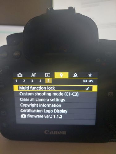

Hi I don't know if you mean the same but I had a similar annoying problem and struggled for hours to fix it. I finally figured it out. Go to this menu setting in the picture below, open "Multi function lock" setting and disable all the options within. I hope this fix your problem too.
