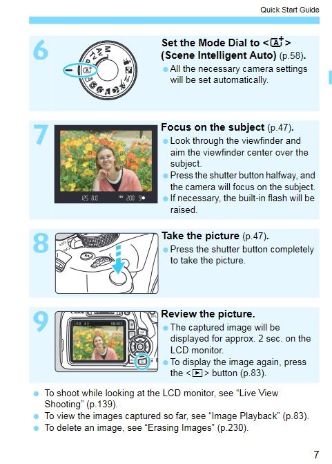

Yes. I can hear it try to focus so I know the motor is working. Or I would assume so. Could you tell me how to put it in green square?
12-13-2021 10:27 AM
If it does not work when set on Green Square in the viewfinder or Live View, it is almost certainly broken.

12-13-2021 11:08 AM
Like this:
