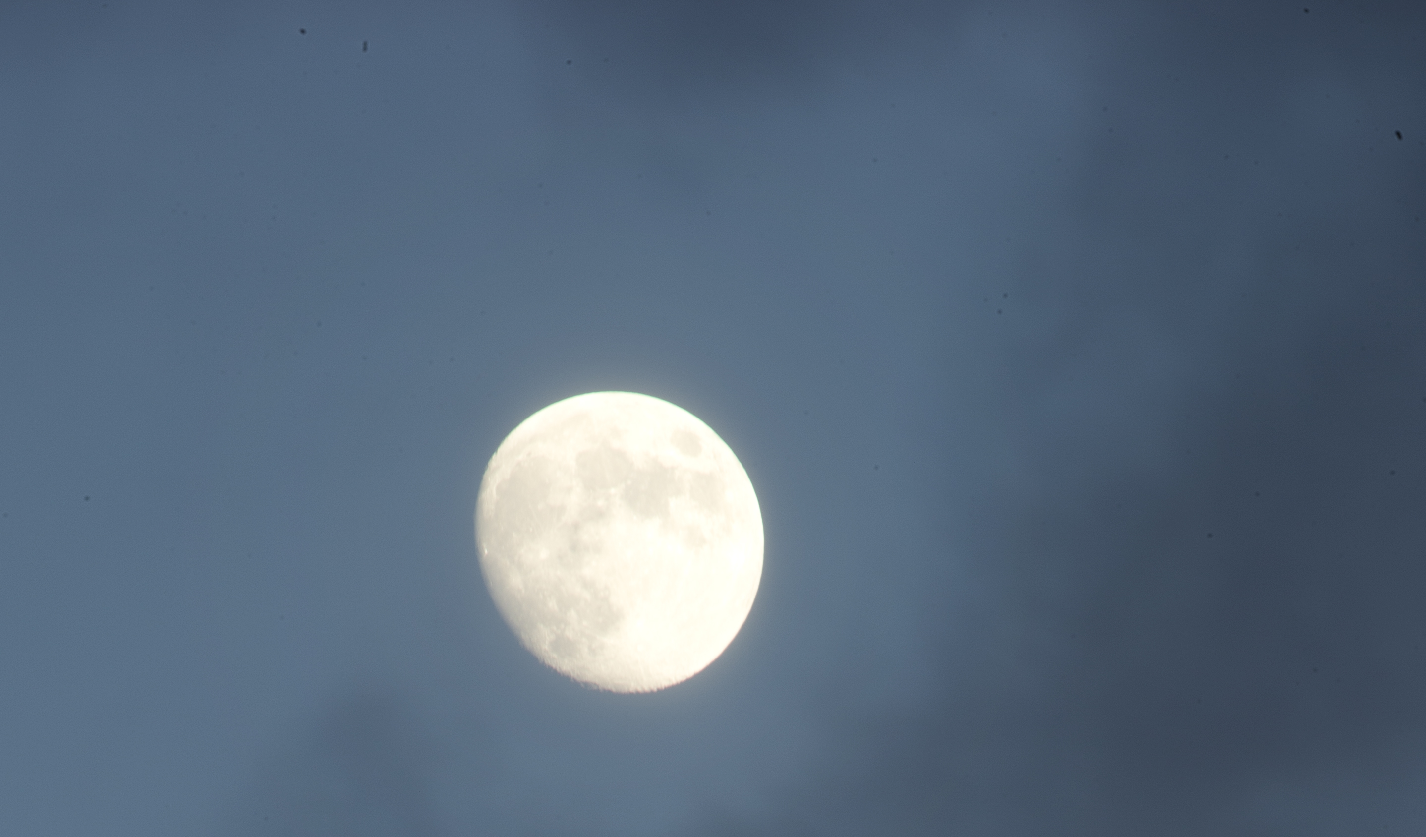

Toto- I posted a link that is almost a spitting image of how filthy my own sensor is- thel ink was to the Fred Miranda forums where a perosn there is havign hte same issues as I've had- I can post my own photo here of a crop though-- My whole sensor was covered in these spots (This photo was just the sky and the moon at f/22 I beleive, so it really showed up) The smaller spots appear to be lubricant of soem kind, and smears, and woudl not respond to air when attempting to air clean- some of the larger particles did fall off, but most of hte spots remained- In 3 years of using my canon 7d, with many many lens changes i nthe field, I've never run into sensor grime liek thsi 1DX showed upion just receiving hte camera- I can see the sensor havign soem dirt perhaps from shipping, storing etc, but this was quite excessive- and if it's lubricant, it's gonna be a bear to clean:
12-01-2012 01:22 PM - edited 12-01-2012 01:27 PM
wow- that really stretched the photo- not sure why- but you can at least see the large spots, and if you look close, or go to my public portfolio to cview the image, you can see all the smaller spots all over the sensor- some faint, some not so faint etc-

Nazareth, Thanks for posting. I see that you posted in canonrumor site as well. Members there are very knowledgeable and helpful .
Here's my take . . .
Comparing the picture you posted contra the picture posted by John Mulgrew @ the other forum site, I'd say that yours are way different in the following:
1. lubricant / spots - is(are) what you see at the other post (not yours). On that picture, though not 100% sure, it looks like the dirt was from a compressed air blown directly onto the chamber at the time of cleaning. Somehow, it was as though the compressed air cartridge was almost empty and spread the debris all thru the nooks of the camera.
In your case, if you have other pictures to examine, check if the [dark] spots are in the same location - picture-by-picture. If they are, then it really might be in the sensor. If not, then it is not in the sensor.
2. smears – I have seen this from what I did long time ago with my F1 camera. Luckily, I have cleaned the mirror, the focusing screen and the bottom of the pentaprism that faces the mirror. If the smear was from the camera lens, you will actually notice a hazy or blurry view when looking at the VF. It's kinda stubborn to clean this with just a swab hence, you will need a lens cleaning paper or cloth and wipe/clean it purposely. Breath onto the lens to see where else needs further cleaning.
In your case, the smear was as though it was a result of an attempt to clean the sensor itself by a cotton swab that has been dubbed with a liquid solution, then, was wiped or left to dry.
If you are adventureous, and not afraid to further ruin your 1DX, and this is at your own risk: set the camera to Bulb, and while holding the shutter, clean the sensor lightly until you are satisfied with the result. I am not going to recommend what to use. Search the internet for the best and safest tool/application to use.
Better yet, bring and have your 1DX serviced by the nearest Canon service center.
Good Luck!

Thanks for responding- The photo I posted doesn't really show the dirt/spots/splatters whatever they are, very well due to the stretching, and it's just a small crop of the whole photo- so it doesn't reall give a sense of the extent of the debri- I also didn't do cotnrast or anything to make htem show up better- so they are kinda difficult to see- but when I take a photo of a white wall or soemthign at F/22- and examien the photo- it's very evident through out the whole frame-
Here's a link to my flickr site where you can right click the photo and choose 'largest size ' and it shows the spots a bit better- some look like dust that actually cast shadows, while other spots definately have a halo aroudn htem like a spot of liquid or somethign would produce http://www.flickr.com/photos/55331349@N05/8235915673/ Most of the fainter spots look like that- a spot with a halo aroudn them that doesn't look like a shadow like hte actual dust spots produce- A couple of larger more prominet spots of debri clearly look like an object with a shadow- but the smaller ones to me look like splattered liquid- I coudl be wrong, but that's what they look like- and hte whoel screen is covered in them
