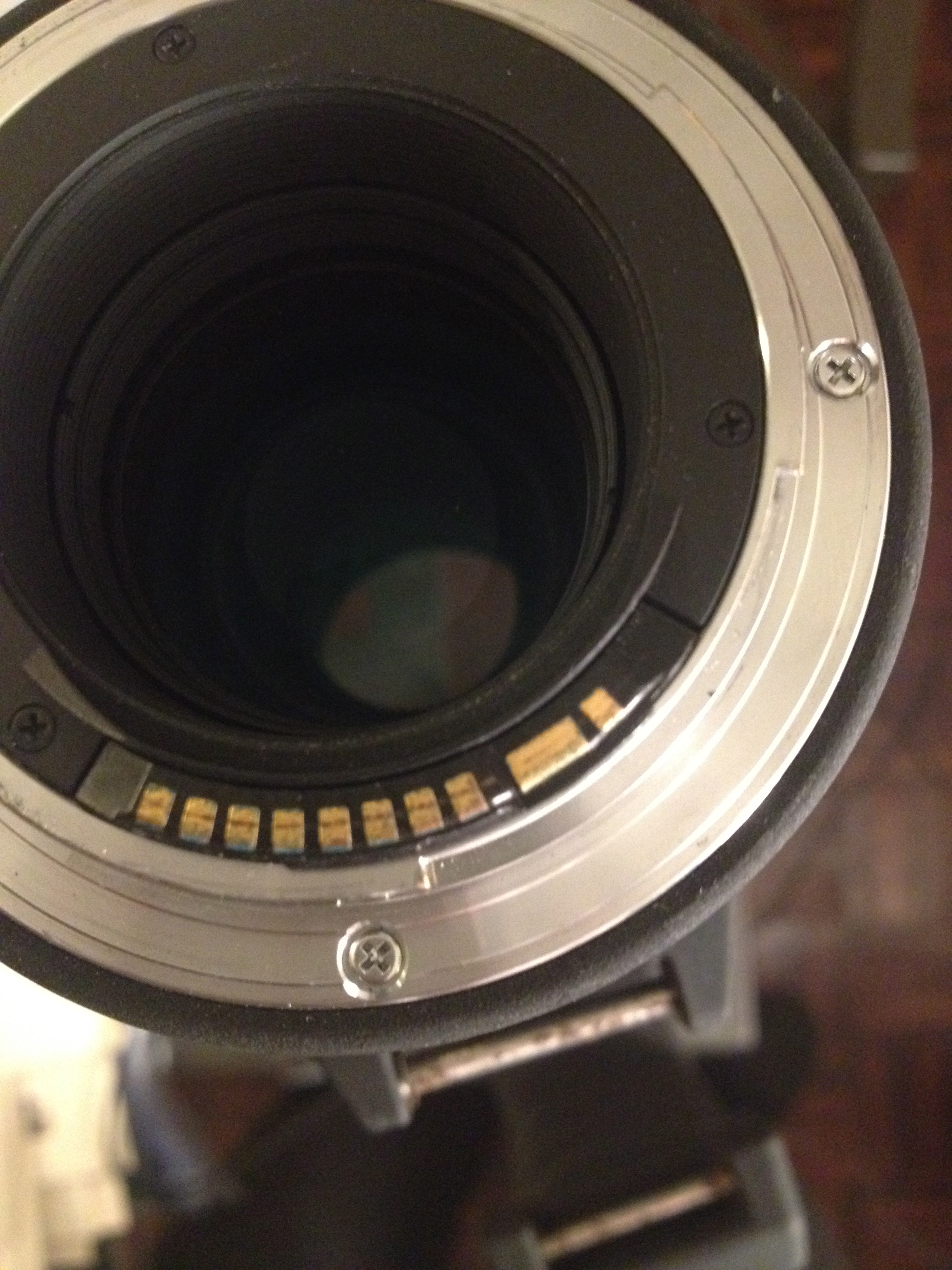

Hello guys I have been getting the following error on a second hand sigma 500mm F4.5 I recently got from adorama on ebay and the seller seems to think its the lens which is faulty. I check the contacts they seem clean but the contacts on the lens look different to the 150-600 C and 17-50 2.8 I have. Could some one who owns the sigma 500mm dg hsm F4.5 post a picture of what your contacts look like so I can compare please. I would like to know if its the lens or the camera.

The fact it works on the 7D and not on the 1D Mk III really tells you nothing. And like I have said many times, cleaning the contacts rarely if ever works. There is gold plating on the contacts and it looks like it is pretty chewed up on yours. This does not mean they won't work. But they may not be totally reliable.

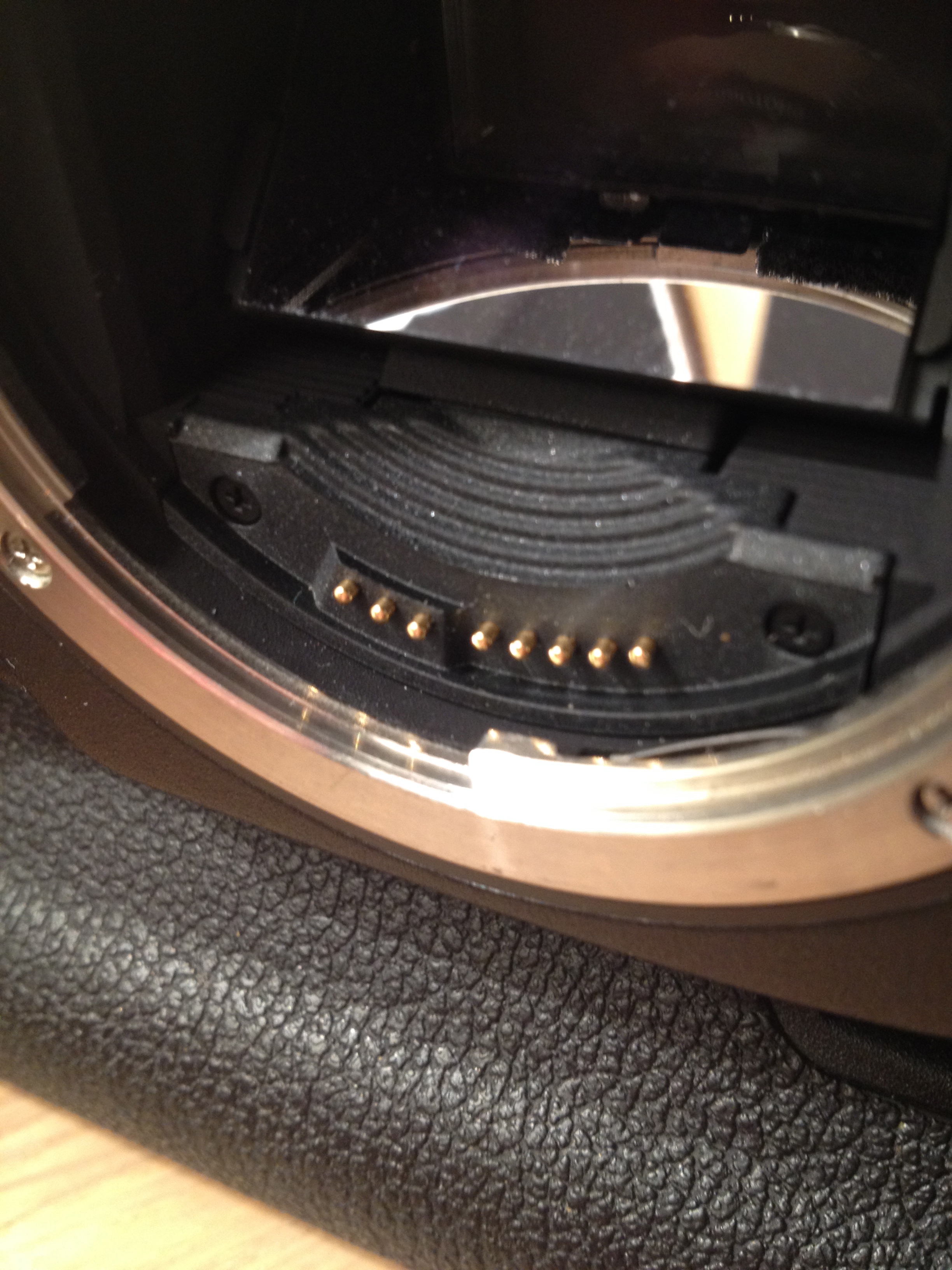

If the lens works with a 7D and another body, but not his 1D3, it makes me wonder what the contacts look like on the 1D3.
02-19-2017 05:47 PM
heres pics of the contacts on the camera
02-19-2017 06:50 PM
above pics taken from canon 1d mk3
02-20-2017 10:05 AM
I would still send the lens to Sigma. But good lord man clean you cameras! Your photos would really enforce the need for Sigma to do a C&C on the lens. BTW, you need to send the cameras to Canon for a C&C too.
