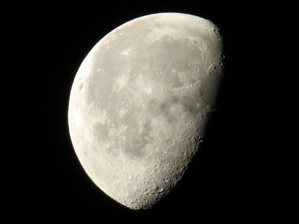

I think you are asking too much of both the camera and the lens.  The T# series is about the cheapest of the camera range out there in the DSLR series, and has limitations with dynamic range compared to higher end models, but the lens is likely your weakest link.  It is arguably Canon's worst optic.
If you are going to shoot images of large objects like the moon, something in the range of 500-600mm on a crop-sensor body is more reasonable, as per the enclosed sample.
Canon EOS 7DMkII, Sigma 150-600c@600mm, f/6.3, 1/800sec, ISO-160Canon EOS 7DMkII, Sigma 150-600c@600mm, f/6.3, 1/800sec, ISO-160
