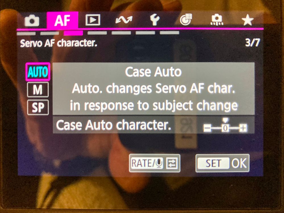

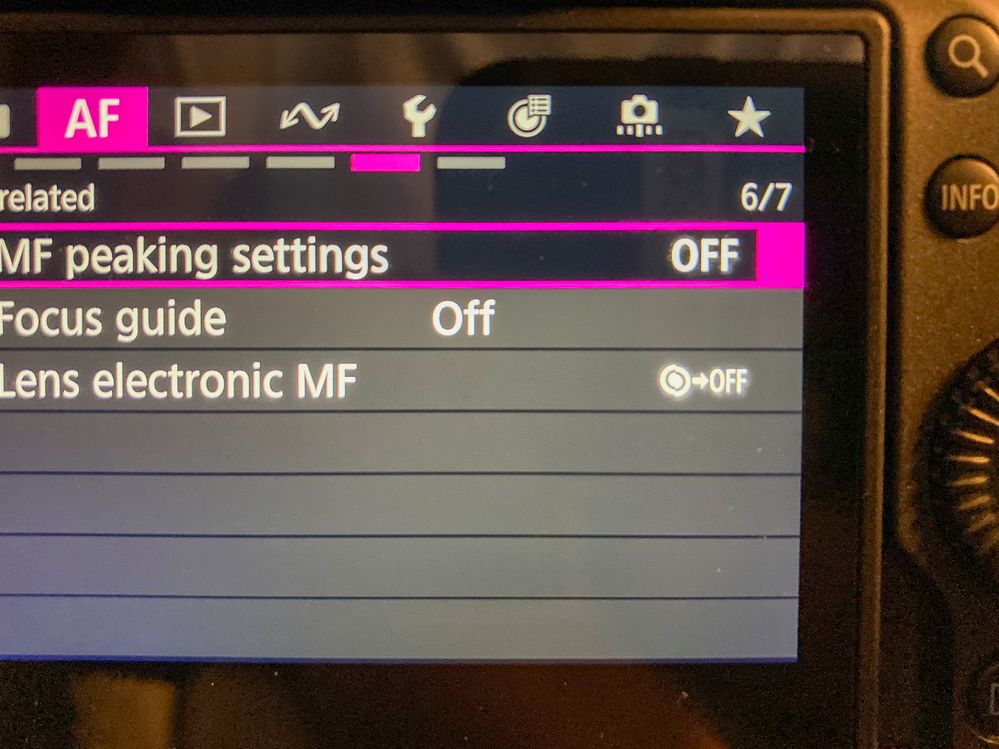

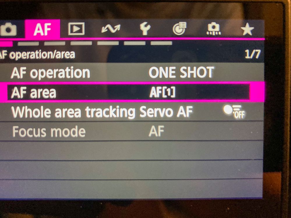

11-29-2025 09:41 PM - edited 11-29-2025 09:55 PM
Here's my AF settings on my R5 II. As I mentioned, I haven't seen the "does not focus" problem on my RF 200-800 for quite a while. I tried several different shots this afternoon starting at 800mm and it never failed.

11-30-2025 12:18 AM
Thanks. I will Use your settings and est that . Though I always Keep Eye Tracking ON When Doing animals and same for. Subject to Setect ON as Animals . However I have Observed Some other Settings Which I will try Now . Shall Provide a Feedback . Cheers
11-30-2025 03:43 PM
Thank you, vantage, for sending the settings. Although for sports and action, I use different basic settings. I don't see anything that stands out in your settings that would make a difference in my case/issue and some are the same on my end.
11-30-2025 05:46 PM
@rgl47,
Understood. If you're still having the problem, it may be worth duplicating my settings to see if your problem goes away. If it does, we know it's some combination of settings that causes the problem and eliminates it.
