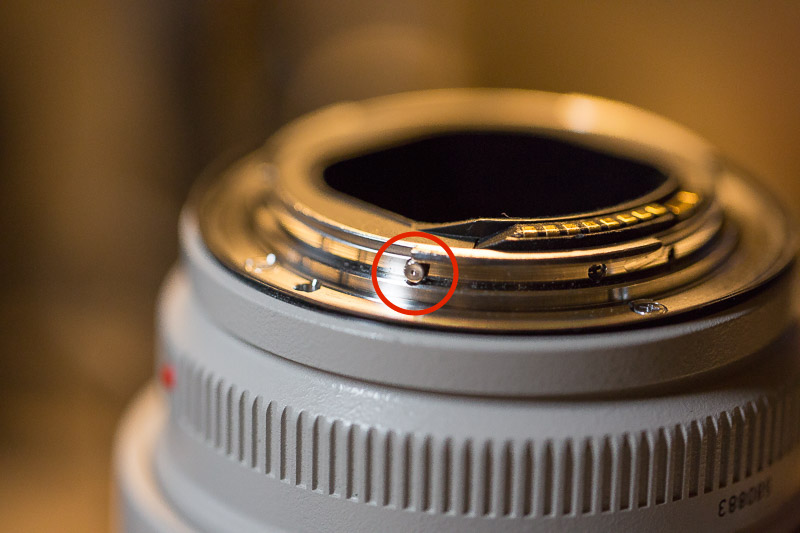

There's a small post on the mounting which acts as a rotation stop. If that stop is gone then the lens can continue to rotate beyond the point where the red dots align.
Here's a photo in which I've circled the stop. Your lens may be missing this part.

Thanks TCampbell, that is the case. Will see if there is posibility of getting that part spare.
