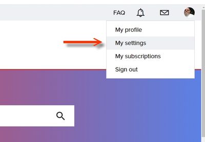

@BK5524 wrote:
"How do you get all that camera/lens info on your replies? Does that help when asking questions, so.the readers can see what you’ve got without having to spell it out every time? (Like I totally forgot to do with some of the info) 😁"
Just click your user icon (where you log in) in the upper right corner of the forum page and select "My Settings".
Then click the "Personal Information" tab.
Is it helpful? That may be up for debate, but I find it useful in mine so that folks can see that I actually own the gear that I am commenting on. Although I own and still use many DSLR's, I chose just to list my R/RF stuff because that is what I primarily use.
