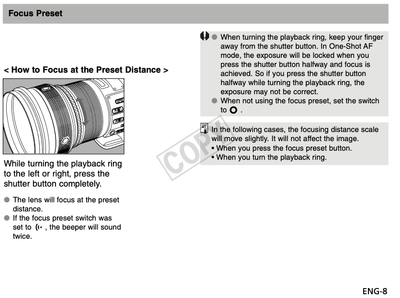

Hello all, I bought a used EF 500mm F4 L IS USM apparently in near mint condition the only issue I have with it is that the focus preset does not work with my R5 or my 7d mark ii. Doe any one have any knowledge if this feature is or is not supported on the R5 or 7d2 with older EF Lenses?
I would appreciate any help, Thx
01-30-2023 06:44 PM
I took these pages from the lens Manual and that is how I am trying to set the focus preset. I don't get a confirmation beep if set to the last most left position of the focus preset switch, and the playback ring does not do anything when I engage it to the left or right.
01-30-2023 06:46 PM
I meant to say the right most position on the switch as you are looking at it.
