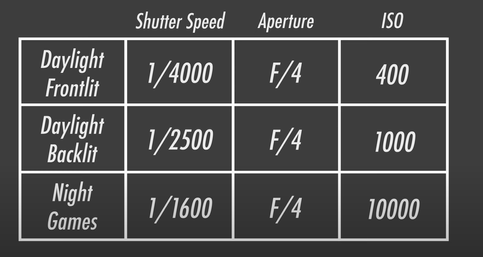

For a deeper context into this. I suggest you take a while to review a couple of videos from Brigham Young University, which offers an insight into the focal ranges they work with.  Their budget is essentially unlimited, so they can afford to get the lenses that have those focal lengths combined with those open apertures.  So, some compromises must be made at this stage.  Note that in the video from BYU, the settings for photography are not down to f/2.8, but to f/4, which gives you a lot more latitude for optics, but also be aware that this is done with Full-Frame, high-end cameras that have excellent sensors for low light work.
There is a lot to learn just about sports shooting as a specific skill and that is on top of learning to use the exposure controls I mentioned.  Learning to shoot sports to a level that people want to invest in is an involved process, as the following videos demonstrate:   Patience is required.  Remember, you are literally just starting out, and you have a lot to learn (you don't know what you don't know at present), and rushing it won't help you, you will just get frustrated - I see that a lot...
To be honest, I would suggest you get used to shooting the field sports in daylight to become accustomed to the camera and lens, and get some skill at using the controls - there is a lot to learn there.  For the speed of sports photography you need to know your camera controls so well that you don't have to think about what to press to get the feature you want and that takes setup, practice, practice, practice and time.
Leave the night events for a while until you build up some skill with the gear.  Apart from fast lenses, if you want to shoot night sports, you will eventually have to consider going to a quality full-frame body - they have significantly better low light performance with sensors of the same MP capacity.  You can't afford to invest in both high-end lenses and camera bodies at once, but the optics are the best long-term investment, while you learn the principles and then get a better body when you can produce consistently good results with what you have got - and that will be a while.
Finally, a note on technique.  Pro sports still photographers don't shoot looking at the LCD panel on the back, they shoot with their eyes to the viewfinder and so, you need to make sure you use good technique to avoid camera shake, the longer the focal length the greater the risk.

the photo showing what shutter speed, aperture and iso should be used in environments is very helpful i saved it to my phone
