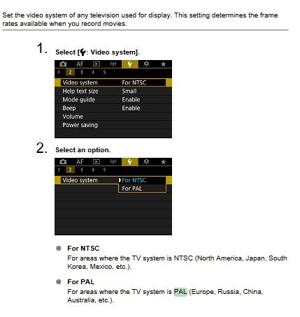

Are you in PAL mode? that only goes to 50P.
