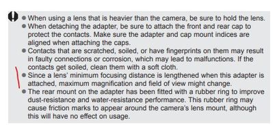

Maybe it is related to this note for the adapter:

If the question is directed at me Ernie, the note says FoV might change.
That could mean the effective FL is seen differently by the camera and thus the wide open aperture is now seen as 1.4 vs 1.2.
Nothing stated that the lens didn't open up, just that the camera was not displaying 1.2.
OP said it worked fine on 5D Mark III and I verified that it reads 1.2 on my 1D MkIII.

"That could mean the effective FL is seen differently by the camera and thus the wide open aperture is now seen as 1.4 vs 1.2."
I'm not seeing that. I doubt that theory has anything to do with it. My ef 50mm f.2L works like it should on all my bodies and every other one I loaned it to. Rick most likely has the answer and resolution to the issue.
