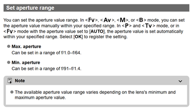

Greetings,
Take a look at the C.Fn2 (Custom Function 2) menu on your camera and make sure the Set Aperture Range allows the lens to operate at f1.2.  I'm not seeing any compatibility issues listed in the lens or R6 manual, but noted the range for Min Aperture is f1.4
Let us know if this helps.

jrhoffman75
I had the opportunity to have my 50mm f/1.2 installed on a friends R7 w/EF-R adapter.
It also only shows f/1.4. It must be a R series camera/adapter combination issue since it doesn't occur with DSLRs.
The min aperture setting in the section of the manual Rick posted is a user adjusted setting. Out of the box it is f/91. It controls the stopped down aperture, not how wide the lens will open up to.
I set my 1D X to f/1.4 and the wide open aperture still showed f/1.2.
