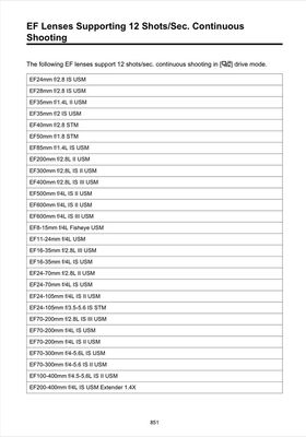

How many fps are you trying to take. Is the camera set to H+ shooting. If so this lens DOES NOT support it.

I believe it does support H+? It has the H+ icon in green on the screen. I have tried both H+ and the "regular" high speed.
Do you believe selecting the H+ has anything to do with the missed focus?
Yes that lens doesn't support it. I have an older lens the EF 85mm F/1.8 USM. The camera lets you select it but it doesn't shoot anywhere near 12 fps.

I have seen another official list where the lens is on the list and heard from other people that it is supported I have the green H+ symbol and I feel it definitely shoots faster than my 100mm f/2 for instance.

I would trust the page Demetrius posted from the R6's manual.  The lens is not listed.  While the lens itself might be capable of H+. it might not be when used with the R6 mkI.
Could it have been missed, sure.  You can check with Canon Support to be sure.

The screenshot is from the R5's manual. But I did double check the manual for the R6 classic. The exact same lenses are listed.

I checked with Canon Support while the EF 70-200mm F/2.8L IS II USM lens does support 12 fps. The R6 MK I (classic) and the EF 70-200mm F/2.8L IS II USM lens. When used together DO NOT SUPPORT 12 fps. The EOS R3 and EOS R6 Mark II for instance do. So I would discontinue using H+ shooting with that lens. Since that combo isn't supported and you're having a lot problems with missed focus.

Alright, thank you for clarifying that 🙂
