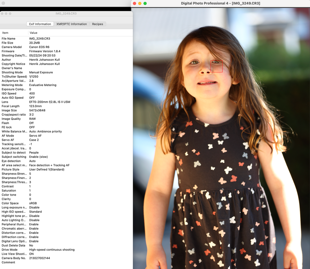

Here is a sampla shot. Often the focus point isn't on the eye too, even if it looks like it when tracking. But I have many shots that looks like this for example. Here she was just walking.
Anything I can improve with the settings?- I have a older 1Ds mark III I have tried it on. On static subjects its nice and sharp, but on my moving daughter it has a lot of shots not in focus, but that can be user error without tracking and a shutter speed of 1/500th. On my daughter standing still it gets sharp shots on the eyes.

Can you share a RAW File with us not a screenshot.
