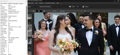

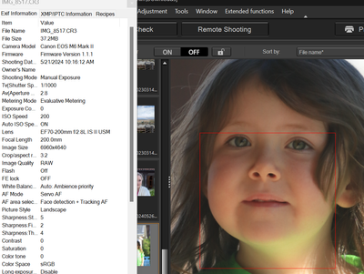

Autofocus 1.2m to infinity
AF
Stabilizer on
Stabilizer mode 1
I've done both, but mainly using the EVF.
The screenshot photo has not been cropped.
AF
Stabilizer on
Stabilizer mode 1
The EXIF in the screenshot appears to report this was captured in Live View.  It you are using a tripod, then that is probably not an issue.  It could an issue when you are shooting handheld with longer focal lengths.
The image seems uniformly OOF, which suggests camera shake.
