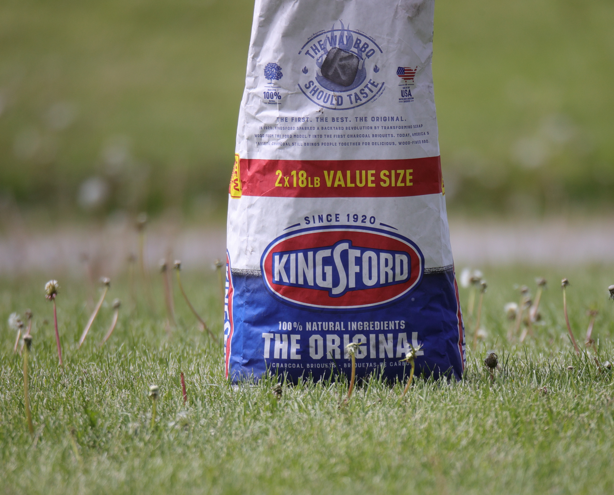

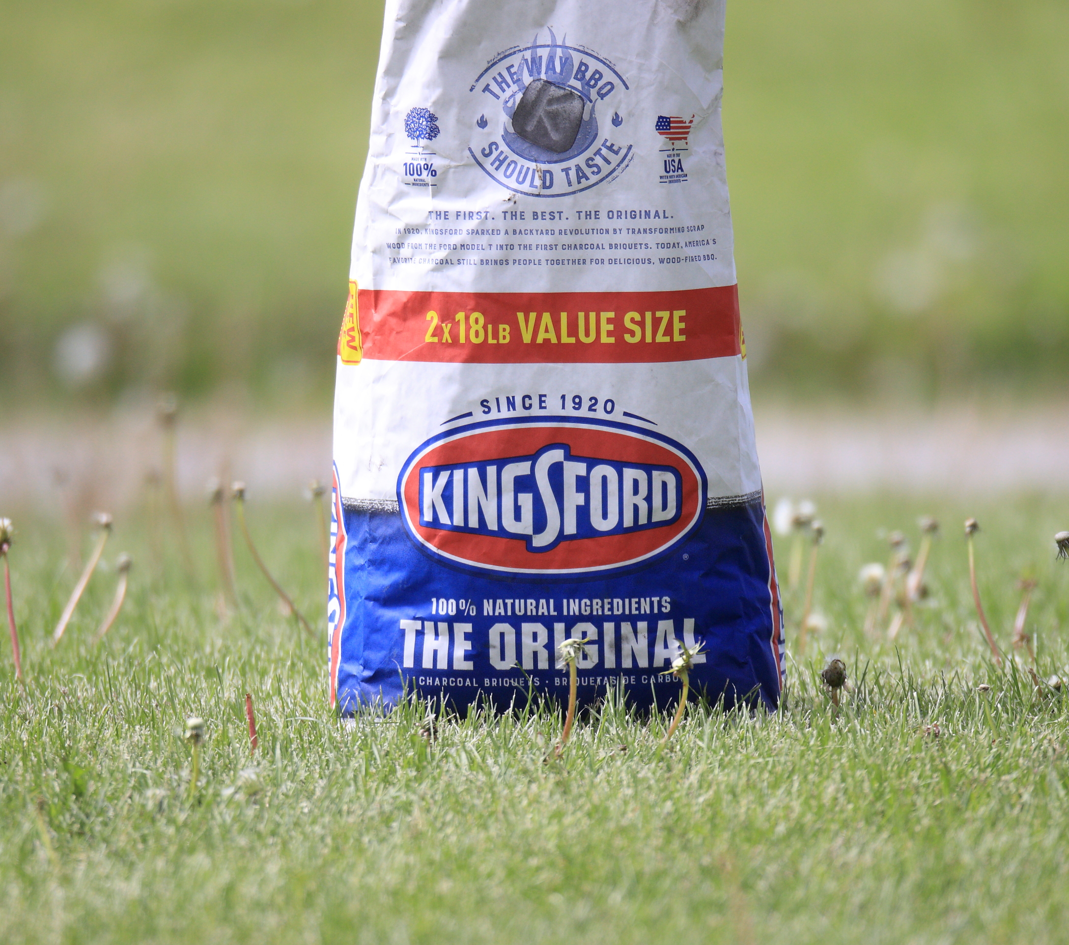

I don't use any special target, for example when I dialed in a new 800 f5.6 lens to my 1DX III earlier this year I was setting up a charcoal grill to cook steaks when Fed Ex delivered the lens and the handy Kingsford charcoal bag and the grass around it made a practical target. The first image below was with no calibration offset and indicated slight front focusing, a +3 offset provided the best focus accuracy for this body and lens.  The same lens on my 5DS R requires a +5.
