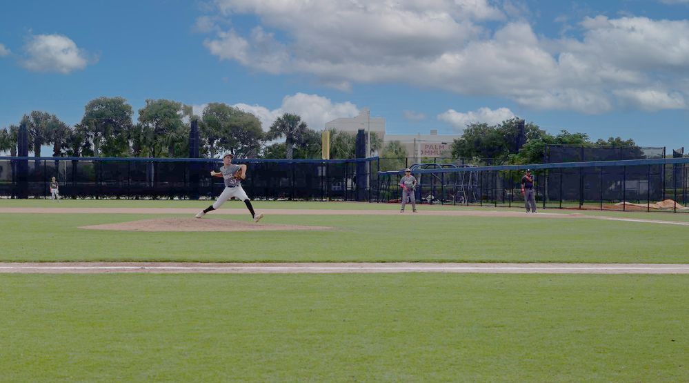

suzigreenburg
this is what it looks like
March411
The image is under exposed so if you can give us a little detail it would be helpful. Were you using the camera in one of it's auto-modes or did you set the aperture, shutter speed and ISO manually? The group here can assist once there is more information.
To stay within your budget the RF100-400mm F5.6-8 IS USM is a good lens and will give you significantly more reach, it is $749.99 new. If you are in the states BH Photo ships fast and can have the lens in your hands in a couple days. You can also pick one up used at BH Photo and take a look at KEH and MPB for one used in excellent condition. KEH has one like new for $637.

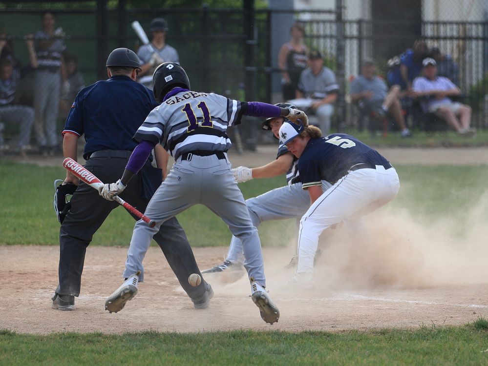

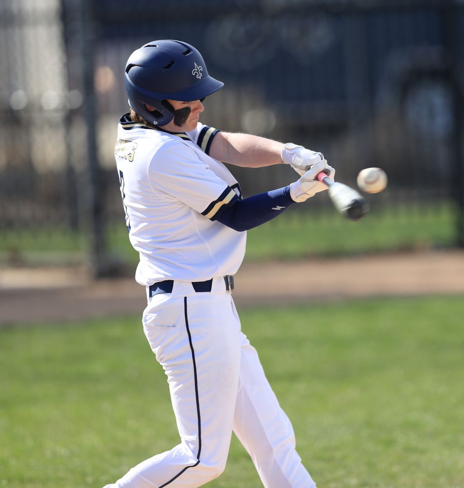

Baseball is a sport that requires a long focal length lens and a 24-50 even on an APS-C size sensor is going to be primarily a "cover the whole field at once" lens even if you are fairly close.  If you have very close access (i.e. shooting through the chain link fence) then a lens in the 200-300mm range becomes workable.  Buying a used lens from a trusted retailer is a good way to reduce costs to get what you need when new isn't in your price range.
As an example of focal length, the first two of these photos were captured with an EF 400 f2.8 lens and the third with a 70-200 f2.8 near its maximum telephoto length and this was shooting from the dugout and coaches area (locations not readily available to photographers and done ONLY with approval of the umpires who I knew well).  The further out you are, the more focal length you will need because excessive cropping will quickly reduce image quality to the unusable level.

Your example photo may be underexposed but the bigger problem is focal length (FL). You don't have enough by a huge amount.
