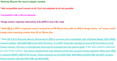

It's not possible to mount an RF Mount lens on an EF Mount camera. A lens compatibility chart is below to better assist you.
