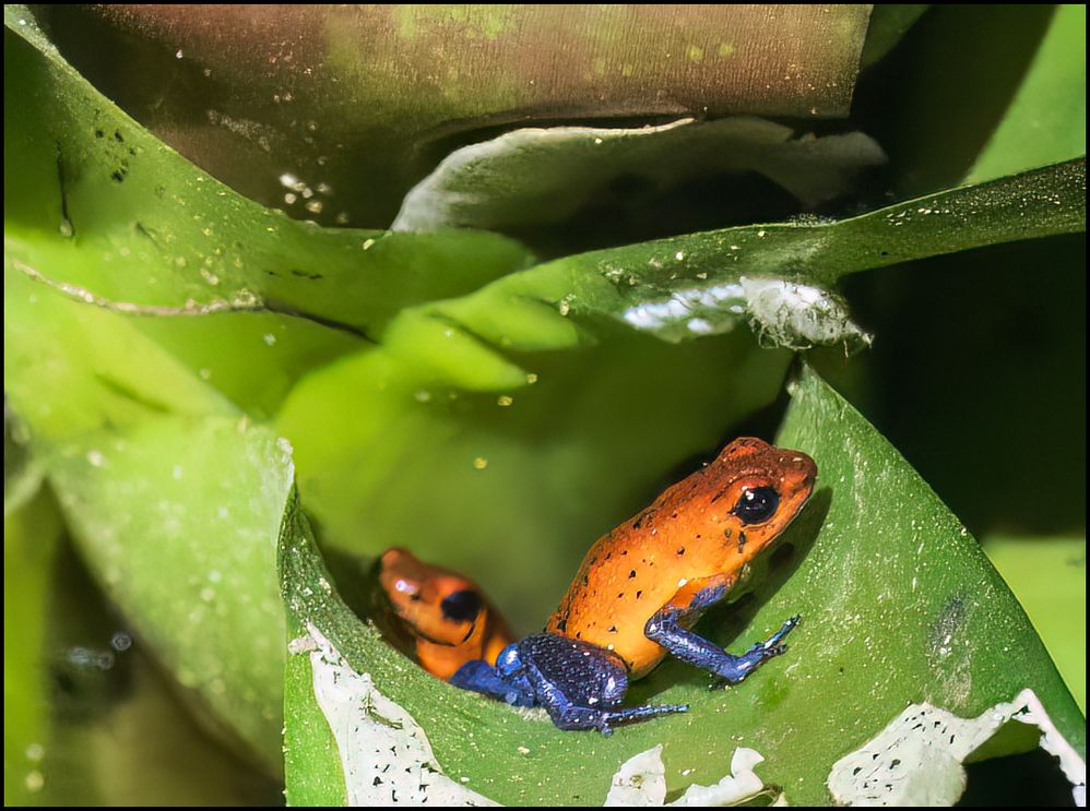

And I'll throw one more lens into the mix. I use the EF-S 35mm f/2.8 Macro IS STM and have had good results. It has a ring light in the lens which is nice, the only down side is battery life. Here is an image captured with the 35mm
