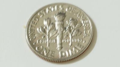

Diopters are not as good as a set of macro rings. This was created from an image stack of 10 photos.
This is what a single image looks like. Note the very narrow band of sharp focus running across the center of it.
