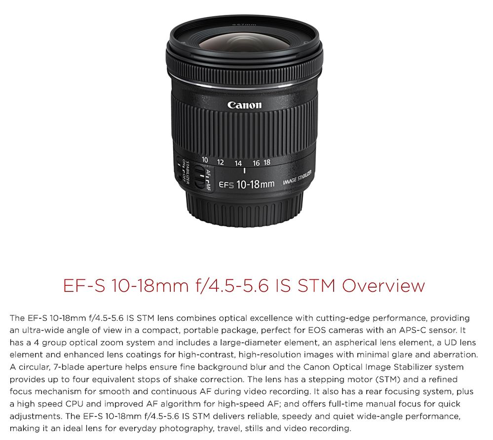

I think the Canon EF-S 10-18mm STM would be great for interior photos on a 90D. It is reasonably priced, and is pretty sharp with very little distortion. Plus, it would be even wider than the Laowa 12mm.

The thing you need to remember is this EF-S 18-55mm f/4-5.6 IS STM will do 90% of what is needed for real estate photography. Yes, likely, there will be some times where it isn't wide enough. It is a readily available lens that will offer more versatile use besides real estate work. The Rokinon 14mm F2.8 ED AS IF UMC is a fantastic inexpensive lens that could fill that gap when needed. I was keeping the mention of distortion in mind since the OP mentioned the Laowa. I also like Mike's suggestion of the Canon EF-S 10-18mm STM

I do agree with Rick the EF-S 18-55mm lens lineup is simply NOT wide enough for real estate work. The EF-S 10-18mm F/4.5-5.6 IS STM would be a better choice for this application. I can't say how good the the EF-S 10-18mm F/4.5-5.6 IS STM lens is because I've never owned or used this lens before. I used to own the EF-S 10-22mm F/3.5-4.5 USM lens and it was plenty wide enough. But the EF-S 10-22mm F/3.5-4.5 USM comes with a price tag though because the lens has a Ring Type USM AF motor. I have since donated this lens to a friend who has an APS-C camera. I replaced this lens with the EF 16-35mm F/2.8L III USM lens when I went Full Frame.

If you want autofocus and auto exposure, as of now there are only two lenses that will go that wide... Canon EF-S 10-18mm f/4.5-5.6 IS STM (~$300) and Canon EF-S 10-22mm f/3.5-4.5 USM (~$650).
