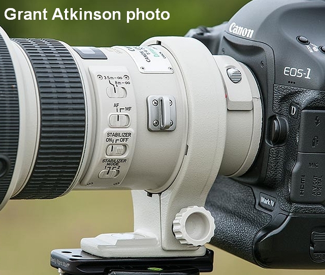

The EF 400mm DO IS tripod ring has 4 cutouts to fit the 4 mounting lugs on the barrel of the lens. It looks quite large and I bet it is unique to the 400mm DO.
I doubt there is a 3rd party version available
Your only options will be to buy a new one from Canon, or else repair the one you have.

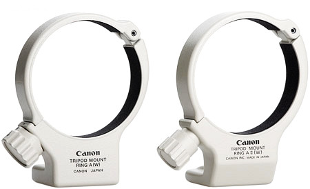

Here are the approx internal measurements of the various Canon rings:
Tripod Mount Ring A 65-66mm
Tripod Mount Ring B 78mm
Tripod Mount Ring C 82mm
Tripod Mount Ring D 68-72mm
"A(W) " fits 70-200mm 4.0L , 4.0L IS, 200mm 2.8L, 300mm 4.0L, 400mm 5.6L, 80-200mm 2.8L
"B(W)" fits 70-200mm 2.8L, 2.8L IS, 2.8L IS II, 100-400L, 100mm 2.8 USM Macro, 180mm 3.5 Macro, MP-E 65mm 2.8 Macro
"C (W)" fits 28-300L, 35-350L,
"C (WII)" fits 70-300mm L
"D (B)" fits 100L Macro
