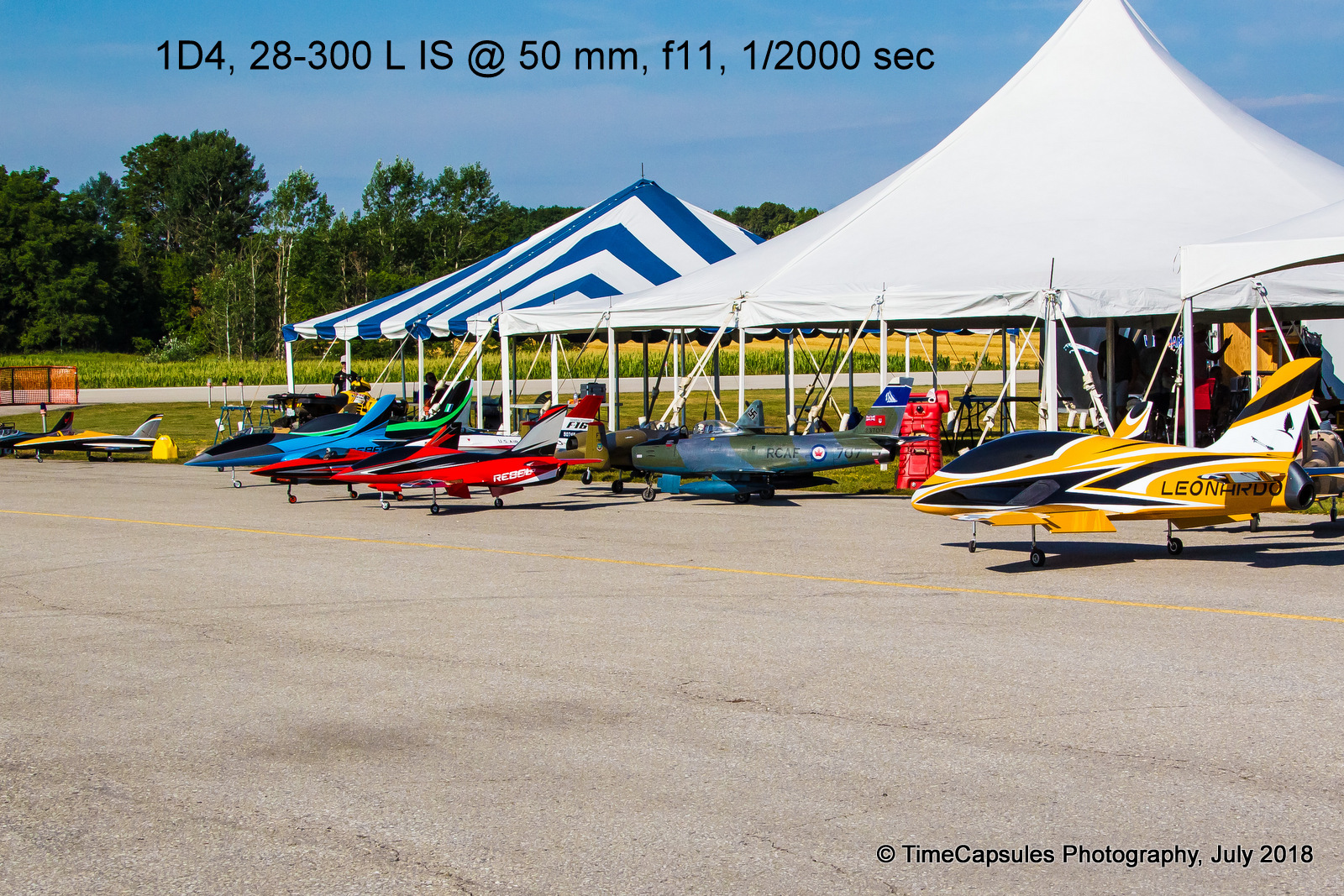

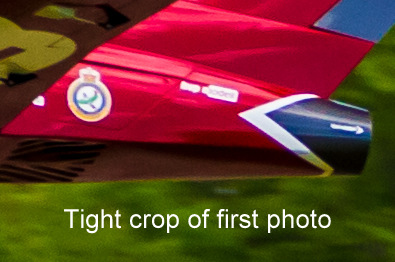

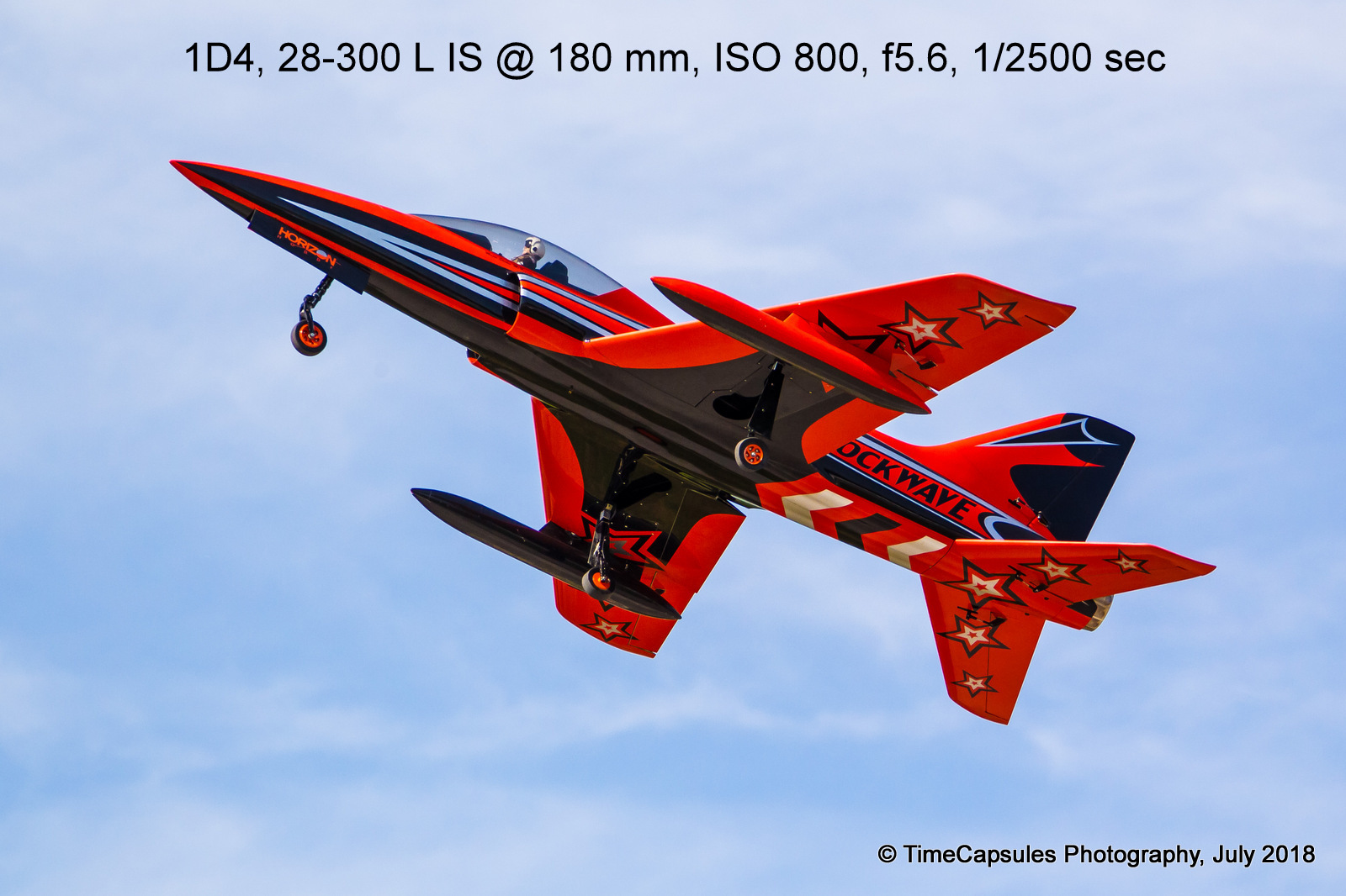

People who bad mouth the 28-300 or older 35-350 seldom speak from the experience gained by owning one. Both are best in class & I own both, and rely on them heavily. The 28-300 however is rather heavy & that can be an issue but after several years of using either of these lenses I have a hard time knowing whether many of my photos were shot with the superzoom or my now sold 100-400 L IS (version 1). The IQ is just too close to call between the 3 lenses. I've taken the time to add some samples & put the shot info on them but unfortunately they won't show all that large here so I'll add a link to one of the forums that has larger images to view.
34973297175_8a9cd9bf4c_o.jpgINGR2299v1.jpg43616039791_b1b9316d9b_o.jpg43616052051_9a8dd19c42_o.jpg42016559234_b6f3fdedc0_o.jpg42684694002_f99e280181_o.jpg
And from the non IS 35-350 L which was obsoleted by the introduction of the 28-300 L IS.
And this is the link to an owners / users group which features sample photos including some of mine starting on this page  (message 1620 & a few pages later). I had other samples there earlier but the albums were removed (by me)  from the hosting site so no longer exist

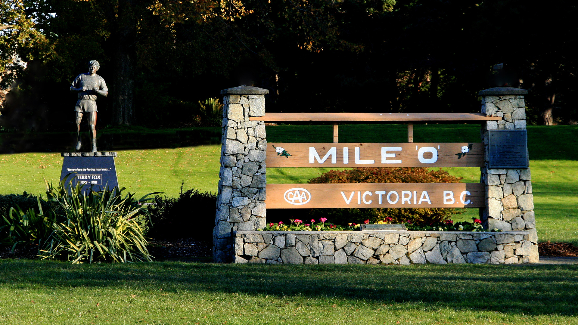

To demonstrate how it can work on the humblest of bodies, here is an image (reduced in resolution for this site) taken hand-held with the 28-300 on the venerable Canon EOS 400D (a 12 YO camera) - I often take my old gear with me for a casual shoot.  Personally I am happy with the results, especially since I was not aiming for professional perfection, but I did want to capture a moment when the shadows fell in a specific way to separate the statue from its background.
Details: 97mm, f/8, 1/500, ISO 800
cheers, TREVOR
