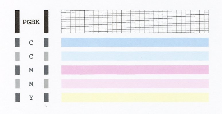

First, a test of the printer should be performed.  Print a Nozzle Check Pattern to confirm whether the inks are being correctly ejected from the print head nozzles and whether the print head is correctly aligned.  Please follow these steps to do so:
 1.  Press the <COPY> button.
 2.  Press the <MENU> button.
 3.  Press left or right arrow key to select [MAINTENANCE/SETTINGS].
 4.  Press <OK>.
 5.  [MAINTENANCE] will appear.
 6.  Press <OK>.
 7.  [NOZZLE CHECK] will be highlighted.
 8.  Press <OK>.
 9.  [YES] will be selected.
10.  Press <OK>.  The Nozzle Check Pattern will print.  Please compare your printout with the example that has been attached to this message.  If lines are broken or white lines are present, clean the print head.

11.  Print another Nozzle Check Pattern to see if the print quality is improved.
