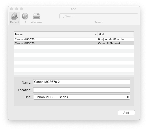

09-23-2020 06:13 AM
Hi all,
If it's not that critical to stick with the 'Airprint' driver which apparently has fewer features comparing with Canon's original driver, I encourage you to print wirelessly via the original one instead. Just download MG3600 series CUPS Printer Driver Ver. 16.40.1.0 (Mac) from their website and install on your Mac.
At System Preferences > Printers & Scanners just click '+' to add a new printer driver (you may keep the existing printer (via Airprint) that shown in the list.
Choose the Canon printer which found through 'Canon IJ Network' instead of 'Bonjour Multifunction', at the 'Use' box, choose Canon's original driver instead of 'Secure Airprint'. Don't forget to change the 'Name' of the printer to indicate that this one is not using the Airprint.
With the original driver, you have more control on the printer like 'draft printing' and other Printer Utility like cleaning, etc.
Hope it helps.
