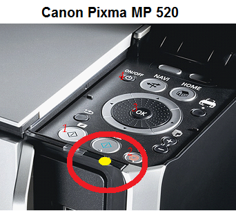

I'm hoping this is a common problem and easiliy fixed, anyone come across this issue before ? how did you resolve it ?
I've spent some time looking around but haven't found any info at all, this yellow light is staying on and for the first time in almost 9 years the 520 is not printing or scanning, can anyone shed some light on the issue ?
10-27-2017 11:41 PM
Problem solved, I fiddled with the 3 color inks pulling them out and reinstalling them utill all 3 were blinking, (these have been dry for years as I only use black ink) I then pressed the Stop/Reset button for the usual 5 seconds, the yellow light went out and now the printer and scanner work perfectly.
