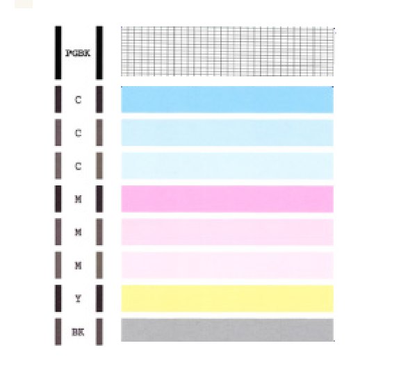

Hi DonaldBHarper,
A test of your PIXMA MG5420 should be performed.  This will tell us if the printer is working correctly.  To do this, please load letter-sized paper in the PIXMA MG5420 and follow these steps:
 1.  Press <HOME> on your PIXMA MG5420.
 2.  Select Maintenance and press <OK>.
 3.  Press <OK> on Print nozzle check pattern.
 4.  Press <OK> on Yes.
The Nozzle Check will print.  Please compare your printout to the example that has been attached to the bottom of this post.  If they differ, please perform a few printhead cleanings.
To perform cleanings, please follow these steps:
 3.  Press <OK> on Cleaning.
 5.  Press <OK> on Yes.
After a few cleanings, please print another Nozzle Check.
Does the Nozzle Check print correctly?  If not, it is recommended that you contact one of Canon's Technical Support Representatives. To contact a Technical Support Representative, please use the link below:
http://Canon.us/ContactLI
