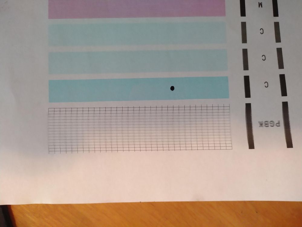

Hello.
Im unable to align my canon pixma, it gives me blur caracter on 3/4 lines.
Encoder seems fine, I have done several cleaning, automatic and manual, let it soak for a while etc.
changed every cartrige.
any other advise?
Im trying to check if I can try one by one the cartriges, but im not sure how to turn of composite black

I have tried cleaning the encoder, didnt change anything.
The issue seems to be with the composite black, the big cartridge.
As i asked, is there any way to test cartridges separatly?
if 4/5 cartriges are aligned, I guess the encoder isnt the issue?
04-09-2025 10:19 AM - edited 04-09-2025 10:28 AM
So I have been able to test cartriges individually, and it was only the PGBK that was clogged.
I unclogged it with a seringe, put everything back and now it gives me a B200 error.
When I get past the B200 error, closing and turning back on the printer several times, I get to the general menu.
But every time I try to print something (copy, from computer, maintenance), the printer shuts down before printing...
what is going on?
