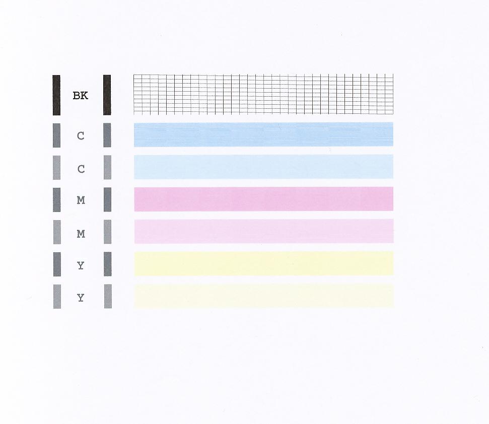

02-17-2020 05:20 PM
Hi Patrick
I followed you instructions and I have scanned the paper I printed off, please see below
02-17-2020 06:31 PM
Hi newprinter.
From the results provided, it looks like some of the Black and Cyan nozzles are still clogged. Try another cleaning or deep cleaning. If that doesn't provide satisfactory improvements, you'll want to replace the ink cartridges with fresh cartridges.
02-19-2020 07:34 PM
Hi Patric
I have tried this claning method several times now using my pc to do the deep cleaning and still no better off.
Is there a manual way of cleaning them by hand?
You see I have been filling the cartrages up with bottled ink (only the once though) and injecting the ink into the conpartment
