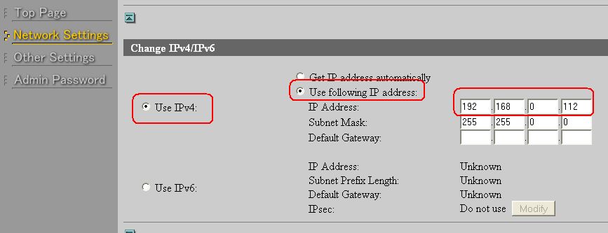

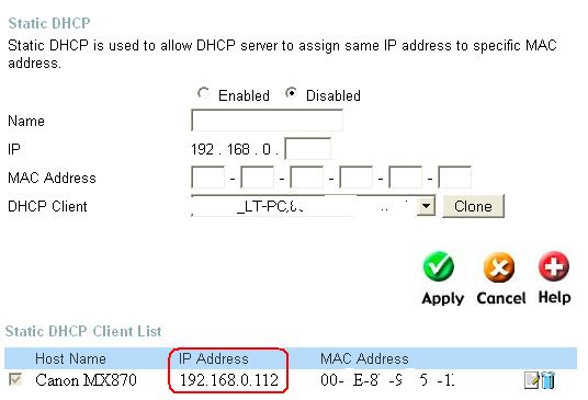

The MX870 comes configured with an IP address of something like 169.XX.XX.XX. My router uses the 192.168.XX.XX range. Once I changed the IP4 IP Address on the MX870, everything worked well. btw, I needed set a static IP address for the printer on my router too. See below.

Now go to your browser and type that IP address in. You should see CANON and Network Configuration at the top of the screen. Click on the Advanced Settings button.
This will bring you to a screen, where you can select Network Settings on the left menu. After you click Network Settings, you'll see the following screen. Make sure Use the following IP Address is checked, and then change the IP address to the one you set in your router as the Static IP Address. In my case, it was 192.168.0.112 (see below)
