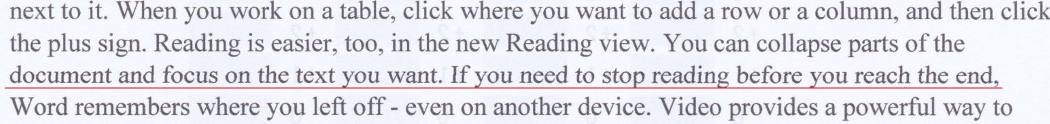

My printer Canon PIXMA MG7753 prints in some lines distorted text. I'm attaching photo below, so you can see what I'm talking about.
Link: https://i.imgur.com/4Cn96tu.jpg (Photo file is too large to upload here)
It only happens when printing in monochrome(everything is fine with colored printing) and it doesn't matter if I make 1 copy or 10 copies of this text, it's always same lines that gets distorted.

02-21-2020 10:21 AM
Hi! Here are a couple of snips from the image where the underlined text shows the problem. Hope this helps!
