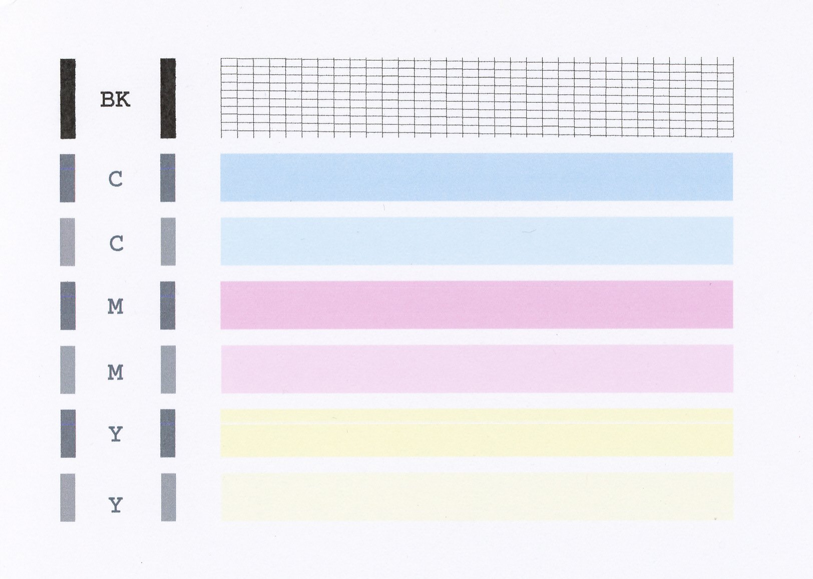

Hi becvu3,
A test of your PIXMA MX420 should be performed. This will tell us if the printer is working correctly. To do this, please load letter-sized paper in the PIXMA MX420 and follow these steps:
1. Press the <Setup> button on your PIXMA MX420.
2. Select Maintenance and press <OK>.
3. Press <OK> on Nozzle Check.
4. Press <OK> on Yes.
The Nozzle Check will print. Please compare your printout to the example that has been attached to the bottom of this post. If they differ, please perform a few printhead cleanings.
To perform cleanings, please follow these steps:
1. Press <Setup> on your PIXMA MX420.
3. Press <OK> on Cleaning.
After a few cleanings, please print another Nozzle Check.
Does the test page printed from your PIXMA MX420 print correctly? If not, it is recommended that you contact our support group using the following link:
https://www.usa.canon.com/internet/portal/us/home/contactus
