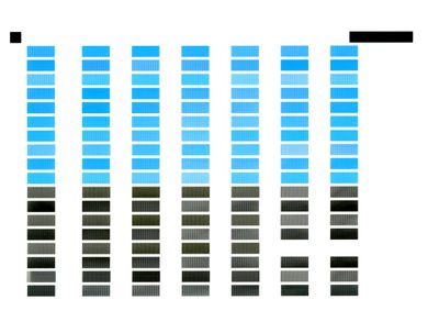

I have the print head alignment chart printed out, so how do I read it? PIXMA ip8720
There are 7 columns with retangular blocks of either blue or black shades. In the 6 &7 columns the 4th blocks from the bottom are missing.

Sounds like you may have a head problem.

This is the print-out of the print head alignment where a couple of the blocks are missing that I mentioned above. Any opinion as to what is going on here? Please refer to my original post.

Print head alignment sheet shows 7 columns of 18 blocks ea. of blue and black shades - 10 blue and 8 black running consecutively from top to bottom. On the 6th and 7th columns, the black blocks 4 spaces up from the bottom are missing.

I don't really know how to interpret the head alignment print-out described above. But I'm wondering if the two missing blocks of black could result in the banding problem.
