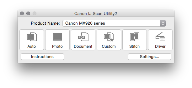

After installing the different drivers etc. from the included disc (after a special install software download) I got an error message every time that told me that ScanGear failed to install each time. I could not get around that. I searched online for a MP Navigator replacement and ended up with "Canon IJ Scan Utility2". I found it here: [Removed 3rd party link per Forum Guidelines]  Although it works fine for scanning do not get this, as it is the wrong utility. I'll explain below.
The interface looks like this:
Note the button on the right that says "Driver". Pressing that button opens the Apple Image Capture interface,
but not a familiar MP Navigator like interface. However the user's manual "MX920ser_Scanning_EN.pdf", on page 82 clearly shows the ScanGear software interface. And on page 6 of that same manual the IJ Scan Utility also looks different. It does not have that "Driver" button. It has a "ScanGear" button.
