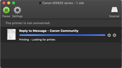

So, with that said, I carefully followed your directions. However, this has not helped my problem at all.  When the printer is first powered up, all the Macs on my network can find and print/scan properly.  However, after a few minutes of the printer going idle, all attempts to print result in the following:
Note the "Printer is not connected." message at the top of the window.

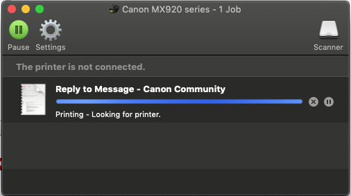

It's further worth noting that I started a continuous ping when I powered the printer up, and as you can see, it never loses a ping, even when the Mac driver shows it having gone offline:
I can also browse to the embedded web server in the printer and see the various configuration options, etc. even after the Canon printer driver can't find the printer.
