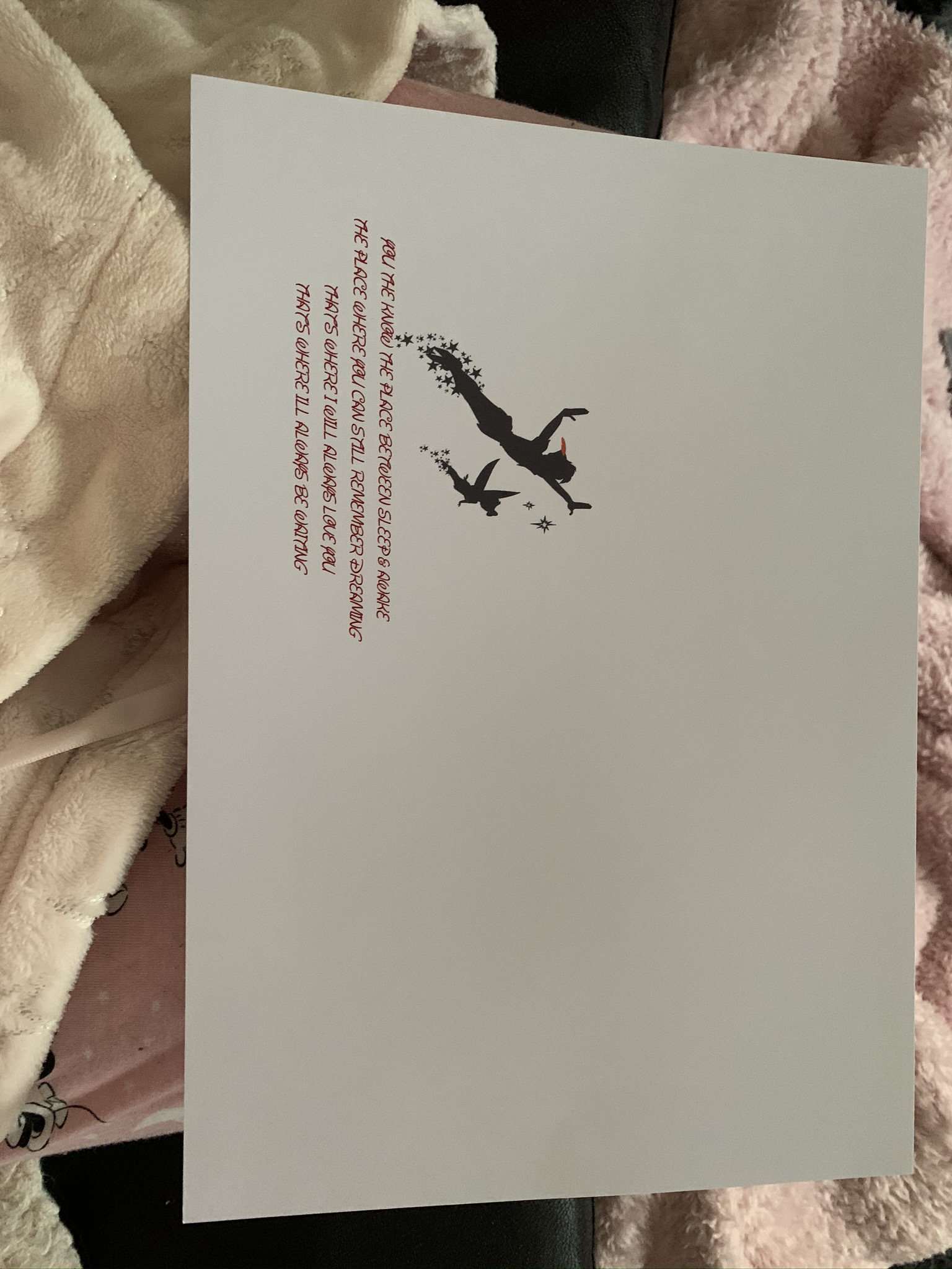

this is basically what im trying to get on photo paper this is on plain paper

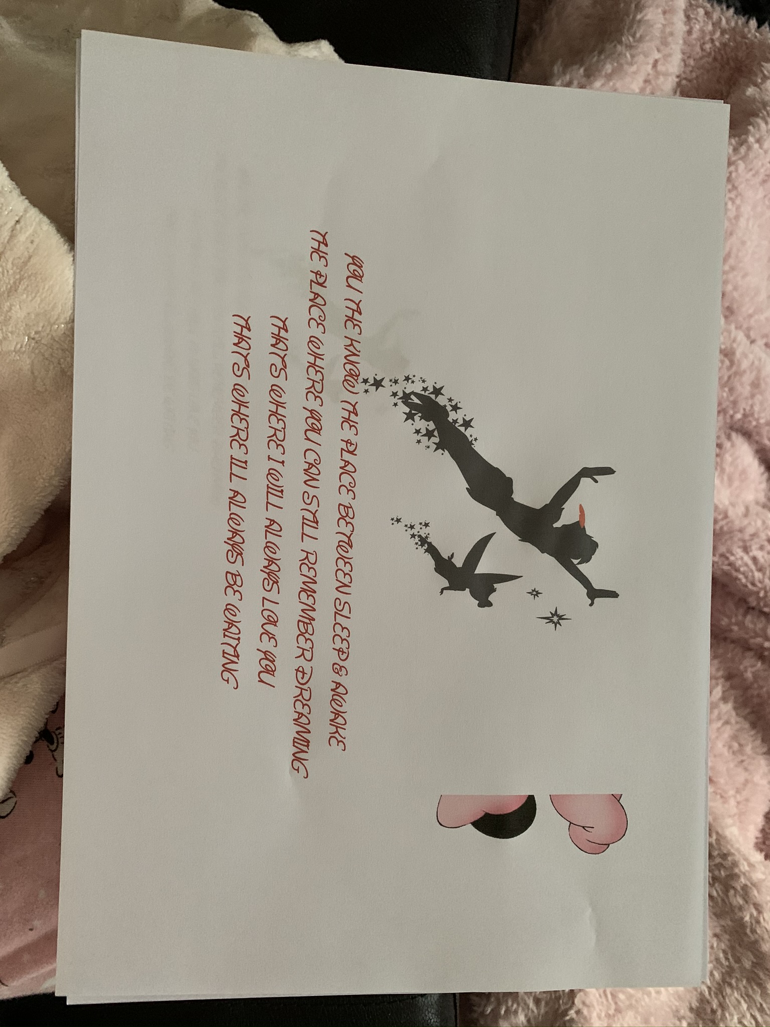

this is what i get on photo paper

im okay with the whole oresentation thing, its just the printing, now thats the size im trying to print onto photo paper but it shrinks it down to a 5x7 or 6x4 and is small

Are you trying to print borderless? Only 3 paper sizes are supported.
(13x18cm, 10x15cm, 13x13cm)
I believe this is tied to the paper type being selected.
Plain paper: A4, A5, B5, Letter, Legal
Photo paper: 10x15cm, 13x13cm, 13x18cm
Envelopes: DL, COM10
Some level of cropping will occur.
Check for this setting when photo paper is selected and see if it can be disabled.
