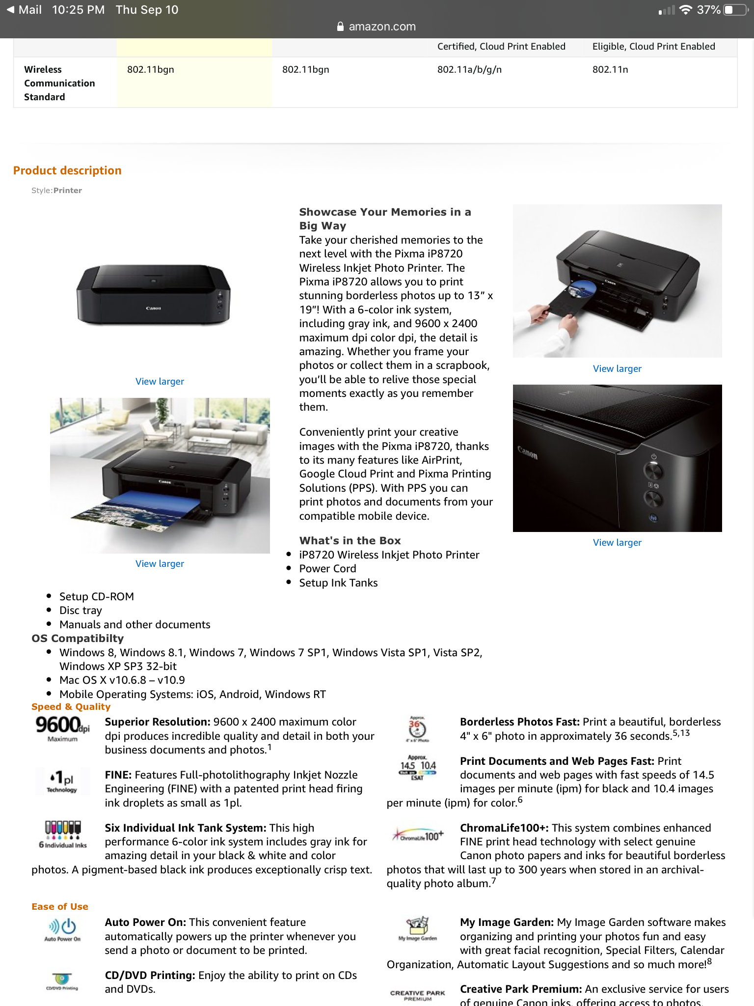

I bought this printer because it was specifically advertised as being able to print 12x12 for scrapbooking. Now I'm seeing that the only way to actually do that is to buy 13x19 paper and trim it down, which is extremely wasteful. Is there no other way? Is there any particular reason Canon neglects to include that in the product description? If this is the case, I will spend the rest of this year (at least) writing enough reviews to make sure everyone I come into contact with on social media knows that they're going to waste enough paper using this printer to wallpaper a house. SO ANGRY

Hi Rick,
 Read the first paragraph of the ad I just posted. It clearly says it will print up to 13x19. I unloaded the Canon software and found a workaround to get the 12x12 prints I need. The point is, for the money spent on the printer I would think custom sizing would be a lot easier than having to use a work around.
