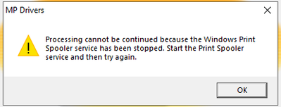

Have been using my Win10 desktop on one TS8360 ok, but have now moved computer location to another area where another TS8360 is the local printer. The on-line installation fails "cannot continue because print spooler service is off..." Have tried to turn spooler back on and restarting desktop many times, and the same error message pops up. Desktop recognises the new local printer serial number and the MP driver files have been uninstalled. I'm out of ideas?

BTW, this is the error message I was getting during the previous attempts at installing the printer.

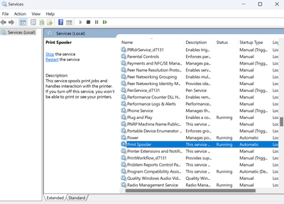

Print Spooler Service.
Windows key + R
Enter services.msc into the run dialog box and press ok
The services applet will open
Scroll to print spooler service. You can right-click and select start from the context menu or use the button at the top of the applet once selected. Wait a moment for the service to start. Then tap F5 or manual refresh to ensure the service remains running.
If so, you are ready to proceed.
